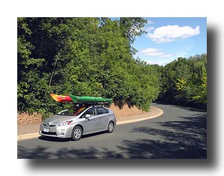

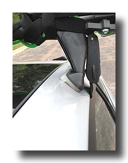

    This worked well for me...

    Those photos are from 2012, as is this detail associated with my purchase back then:
    • Q-Towers 4 = $130
    • Q-99 Clips 2 = $30
    • Q-5 Clips 2 = $30
    • 66” Round Bars 1 = $55
    • Mako Saddles 2 = $60
    • Hully Rollers 2 = $70
    • Lock Cores 1 = $35
