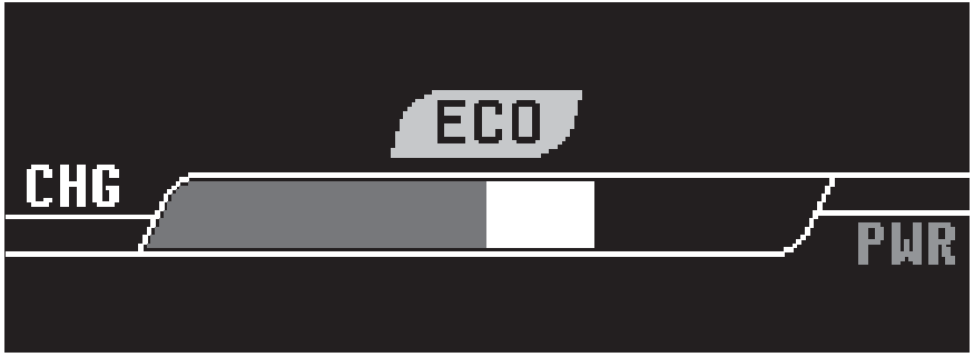

    Sorry if this topic has been addressed in other threads. I did a quick search and didn't find anything similar. I hypermile all the time, so when I say accelerating out of a turn, I mean only the gentlest of acceleration, maybe at 1500 rpm, or with the HSI indicator of throttle just to the right of the ECO light as shown the diagram below.
