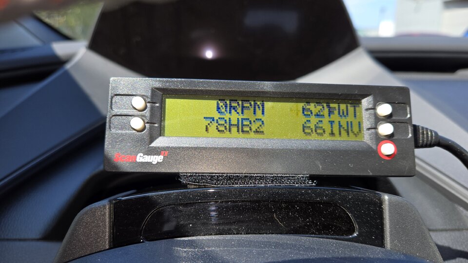

    Anyone knows why my Scangauge 2 is killing my Gen 5 battery? It used to work flawlessly in my 2021 Prime but now, it seems like it's useless in my 2024 Prime. I've set it in hybrid mode. Would have wanted to use it to monitor various temps and RPM..
    TIA!

    Yep! Had an answer.
    Is your 2024 Prius Prime plugged into the charger?
    The ScanGauge unit will wake up when a plug in hybrid vehicle is being charged. The ScanGauge reads the rise in battery voltage thus causing the ScanGauge to wake up. This is normal. Unfortunately there is no way to turn this off other then to unplug the ScanGauge unit while the vehicle is being charged.
    Weird thing is, my 2021 Prime wasn't doing this.. anyway. Guess we have an answer.

    Hmmmm.... it certainly wasn't pluggen in at work but the scangauge is wide awake... looks like it's a no no on a 5th gen...
