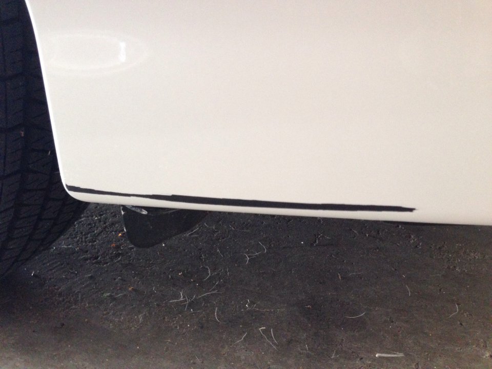

    I just went outside and noticed my lower front passenger side bumper has a big scratch on it. I don't remember hitting a curb or front brick stop. My wheel is not scraped.
    I did have a valet park my car at a hotel the other day. I am thinking they must have done it, but I have no idea how I can blame them as I did not notice the scrape until 2 days later.
    I am wondering what was hit to cause this scrape.
    Thank you for your help in advance.

    Not much you can do about it unless the valet that did it admits it (doubtful).

    ugh, i hate valet parking. i purposely won't go somewhere if that's all they have. tough to tell from the pic, looks more like black paint than a scrape.

    Nope, my Super White SE has a similar scrape on it. There's black plastic under some areas.

    It's really easy to do scrapes like that: roll into a parking spot with a wheel stop curb that's just slightly too high.
    Get the touch up pen in your color, lay a scrap of carpet down, wipe down the area with isopropyl alchohol, then fill it in. Take your time, overlap slightly onto the painted zone.
    Get off the ground, step back 3 feet, have a look, you'll hardly see it.
