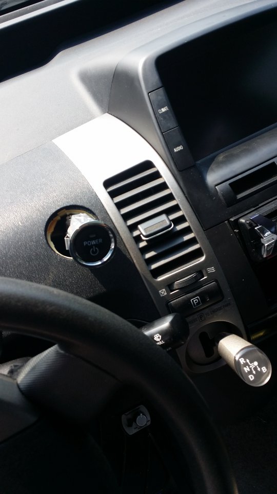

    While I had the dash apart I added some color to the ring around the power button.
    At night with my ambient led.

    Where did you get that LED ring for the power button?
  6. Sezy
    Sezy Active Member
    Oct 19, 2013
    442
    230
    37
    Saint Charles, Missouri
    2020 Prius Prime
    It's still the factory part just painted white. It looks blue like because I have a blue led aiming down from infront of the sunglasses holder spot.

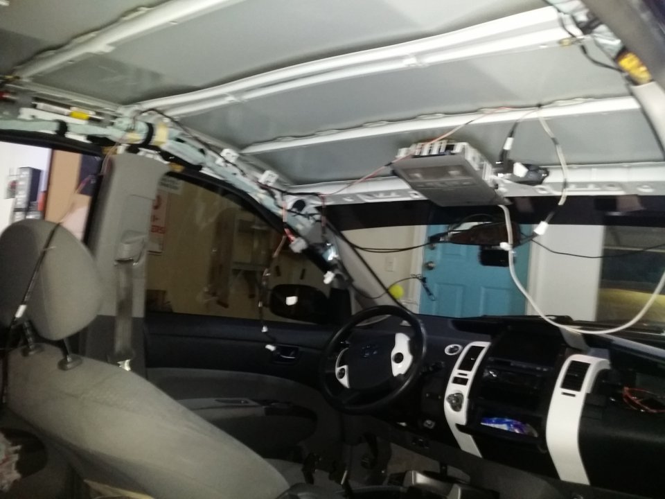

    To work on some hail damage I pulled the headliner and did a terrible job of popping the dents out. A week later I was like "Why didn't I paint the headliner?!". Had some left over exterior house paint and bought some fabric medium to try keeping the fabric soft.
    Wires all over!!!
    So I remember how this light fits in. Note the bent metal clip. 20160625_231308.jpg
    Pulled out from the trunk. Had to bend it a little.
    Theses wires were a paint. Had to pull them off their sticky tape mounted spots and separate from the insulation. Arg should have did some sound deadening spray. Oh well.
    20160626_005150.jpg 20160626_005237.jpg 20160626_005201.jpg 20160626_185112.jpg 20160626_185137.jpg
    Redid the arm rest too. Tightened it up finally while it was off.
    Fabric is a little rough to the touch but no where near what it is like just spray painting it. Still soft enough not to make people ask whats' wrong with it.lol

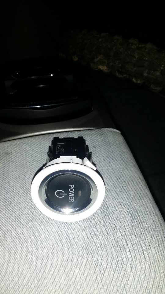

    @Sezy , So was that a stock white ring or something you added?
  16. Sezy
    Sezy Active Member
    Oct 19, 2013
    442
    230
    37
    2020 Prius Prime
    Here I am taking the stock OEM chrome one out.
    Here is the same OEM ring painted white. Nothing magic about it lol.
    Xterra72 likes this.
