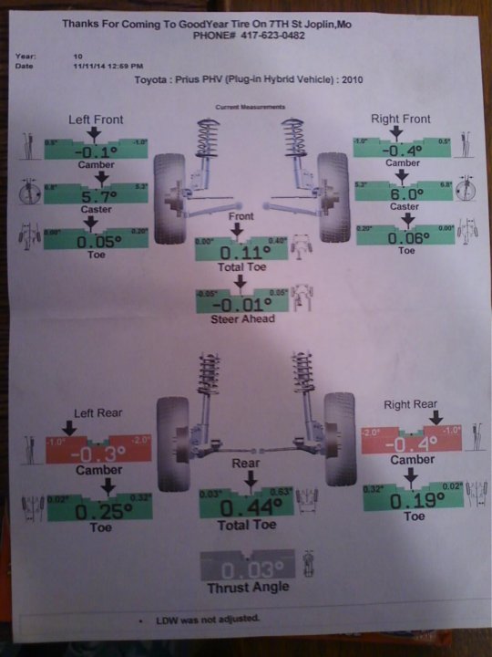

    I will have the struts checked. Hmm, the old tires may have had about 50,000 miles on them. That is a guess. I got a print out and will try to post a pic of it if I can. I just read a post here that said the shims were not for disc brake cars, then it said all Gen III's were disc brake cars. It also sounds like if you have the shims you have to keep checking them all the time, like weekly for a while, etc. I really think I just want them off. Will that be a problem to have them removed?

    That print out was from the day I went back to have them check the balance and they said the driver front tire was 2 degrees out of balance or something like that. So, that reading is from a few days after the shims were installed and the tires put on (the ones I have since returned). Does it matter that they put that it is a plug in, when it is not a plug in? Would the recommended numbers be the same?

    Sorry, I was talking about spacers and didn't think about the shims they use during front-end alignments. If they say the alignment is right, and the image you posted suggests it is, then I'm not sure how those would give you the ride you are describing unless they are somehow making the wheels wobble or something. If the wheels are aligned and the tires are balanced, then it might be tie-rods or struts, though neither seems likely given the mileage unless there was damage somewhere along the line. Might be time to find another shop who specializes in front-ends and see what they say, sounds like Goodyear has washed it's hands of helping you. I still don't understand why they don't see the problem if they take it for a test drive. I once had to take a Meineke mechanic for a test drive twice before he heard the brake problem I was describing and then he knew exactly what it was.

    It's troubling that you are being called crazy; new tires or alignment changes can dramatically alter the way a car drives and handles and apparently both these things have been done to your car at the same time. The alignment printout you posted (assuming it is accurate) doesn't show anything that would produce the symptoms that you are describing but I feel that the shims should be redone or removed because the rear alignment settings are now outside the range specified by Toyota for your car. As I say, I doubt this would produce your problems but could well alter the emergency handling in unpredictable ways. The ideal solution to maximize tire wear in my view would be to reshim to one degree negative camber and as close to zero toe as possible. (toe is a much greater factor in tire wear than camber). It may be beneficial at this point to look at the car on another alignment rack to eliminate possible rack calibration errors or operator error. I'm curious why a Goodyear dealer would sell you Tripletreads- showing up in a Prius would tell them that gas mileage mattered to you making Assurance Fuel Max a better choice. You should not have to pay to remove the shims- a conversation with the store manager or Goodyear customer relations is in order. Gently point out that they created a potential liability problem by going outside the accepted range.
