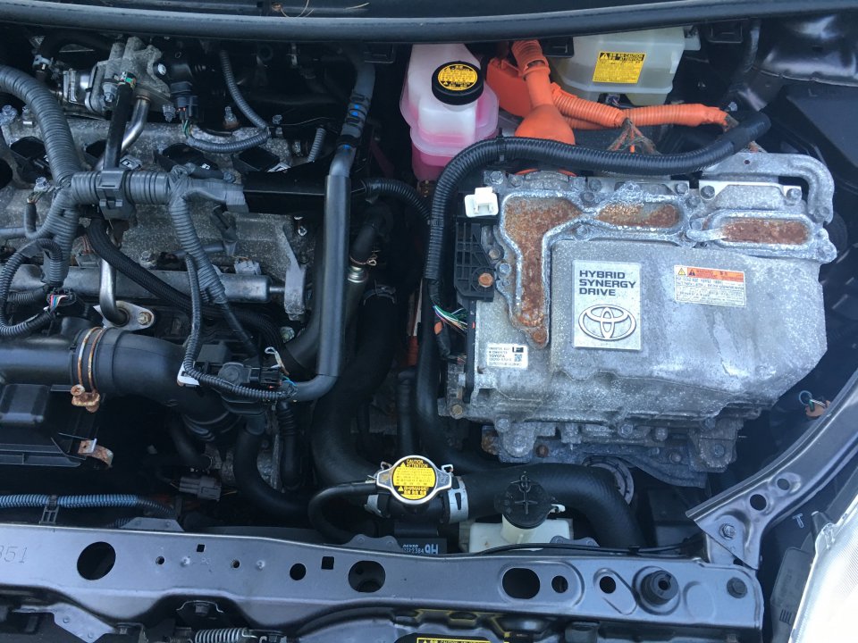

    Ok I think I found it. If I'm facing my hood, is it on the right side
  10. ChapmanF
    27,345
    17,950
    In the foreground here, you can see the pressure cap (shiny metal cap with yellow label, on a black fitting between two hoses), and the black plastic reservoir cap on the white overflow reservoir next to it.
    The narrow hose leaving the pressure cap fitting to the left ought to end up at the overflow reservoir, though it isn't easy to see in this photo.

    Yes I see it. The shiny one. Should I open that and add coolant?
  12. ChapmanF
    27,345
    17,950
    Two steps. When the engine is cold:
    Open the shiny cap, look in there. Coolant should be right up to the top of the neck where the cap gasket sits. If not, add some coolant. Put the shiny cap back on. Be sure to twist it clockwise all the way.
    Now check in the white bottle right next to it. Is that coolant up to the FULL line? (See the drawing Mendel posted in #3.) If not, pop the black cap off that bottle, add coolant to the FULL line, put the cap back on.
    While you are there, it should be easy to confirm that the narrow little hose from under the shiny pressure cap leads to the white bottle.
