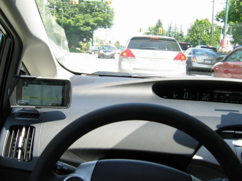

    My Motorola I had suction mounted in the little window like above.

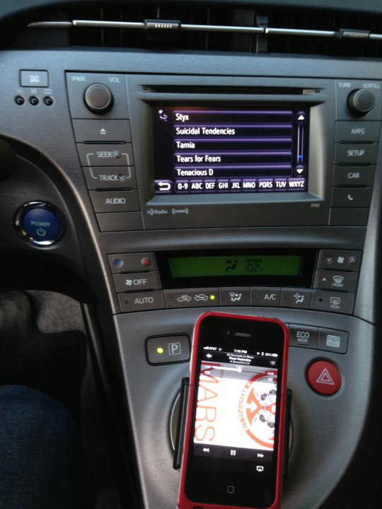

    I bought one that mounts into the cd slot. I love it. It doesn't block my windshield at all. It does block the view of just a sliver of the cars touchscreen but it's causing no issues so far. I find right there to be about the best location for me with it being within arms reach on my right. I'm not a fan of GPS or phone mounts anywhere up in the windshield area.
    Bullet Salvador likes this.

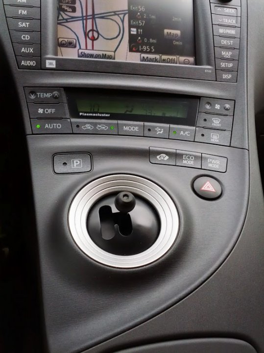

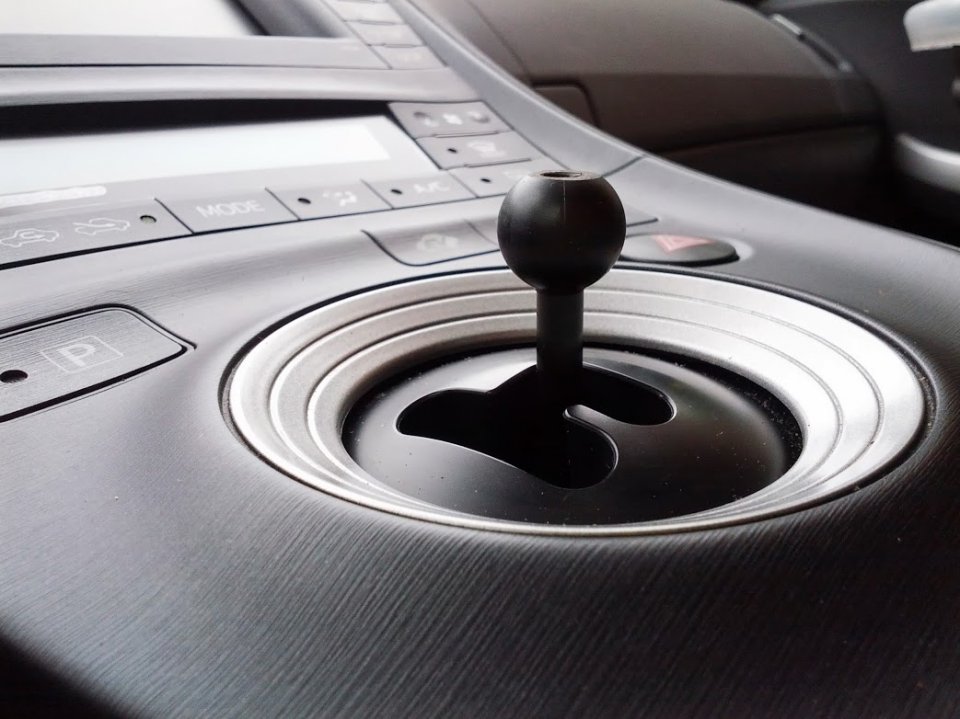

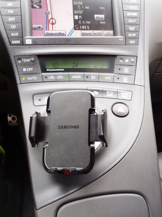

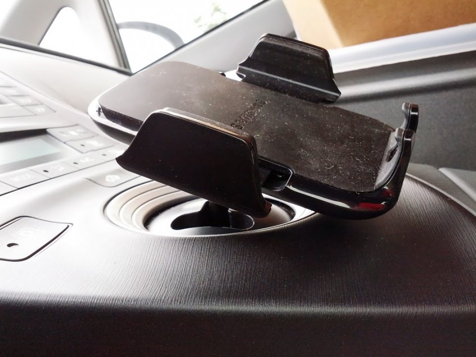

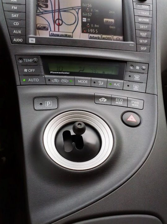

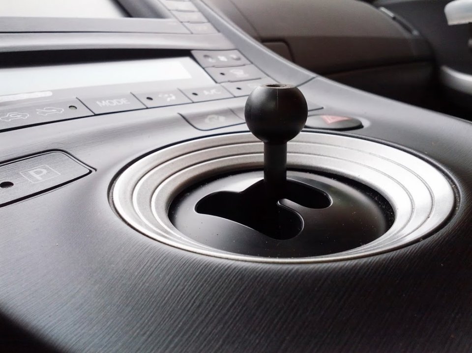

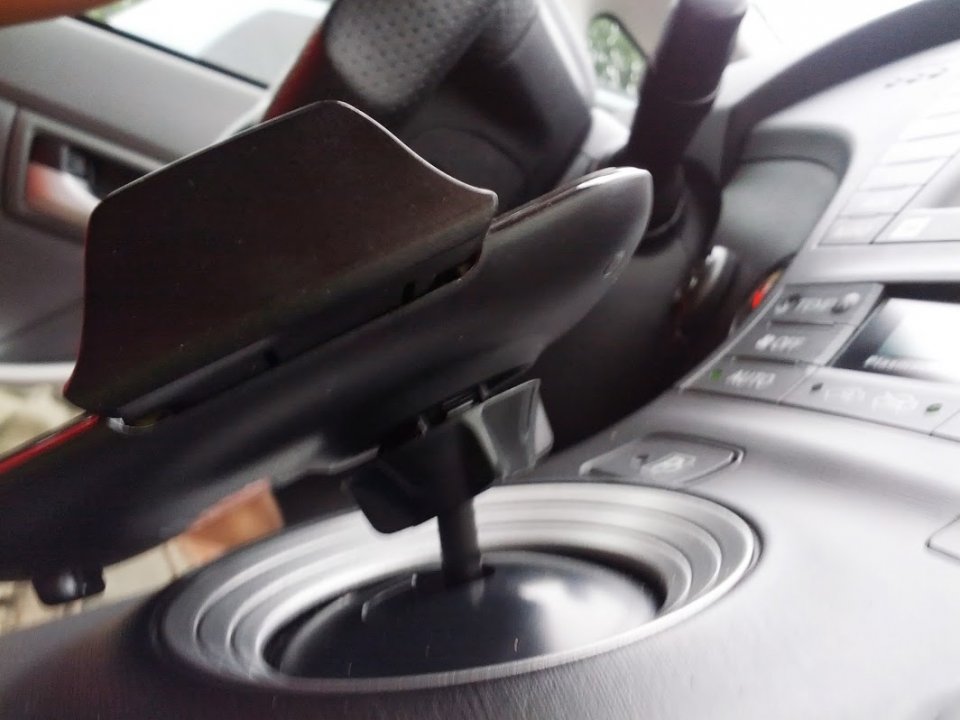

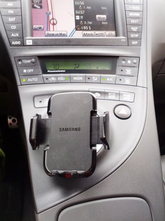

    I finished my DIY phone mount last night. I finally got the thread tap tool that I was waiting for. I was inspired by a fellow members iPhone phone mount solution where he custom made a wood mount that replaces and screws on top of the stock shifter.
    I have no problems shifting the car into R, P, D, N, or B. It's actually very comfortable since you just slide your phone in the proper direction.
    With the ball mount, you can angle the phone to whichever position you prefer. You can lock the mount in it's position with the tension screw under the mount. The mount doesn't swivel and remains locked in place. You can easily adjust it to landscape mode.
    The phone is in a very comfortable position for your hand navigate the screen with your thumb. Not awkward whatsoever.
    Here is my new shift knob!
    Here is the phone mount on my new shift knob :)

    This was what I started with. I have a few pics on the hack process. I basically took the base (window suction and ball end of the joint) and hacked off the ball from the rest of the base. I left a little bit of the neck on the ball so I could have some material to work with if I needed it.
    I put the ball on a drill press and put a small hole straight through the center. I sanded down the neck and tapped the thread all the way through the ball. The thread pitch is M6x1.0

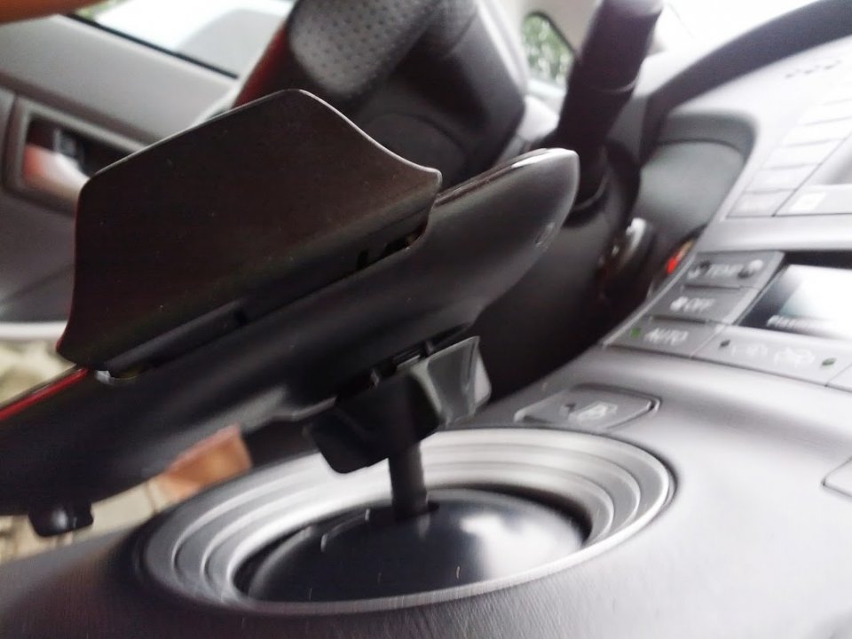

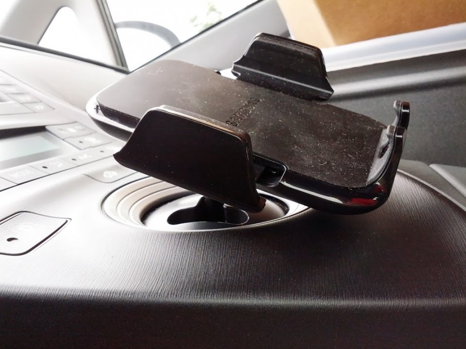

    Here's mine.
    Screwed right on, took 1 minute.
    Do a search on Amazon for 'in your face iPhone', and get the gooseneck clip on holder for $26. I've had one for years, and found that if you unscrew the holder from the gooseneck, the ball (part of the ball and socket) will screw right on where the gearshift was. Unscrew the shifter, slip the tightening ring over the stick, screw the ball in, put the iphone holder on the ball, tighten the tightening ring, and in less than 1 minute, you're done.
    No drilling, tapping, or glueing, and if you want to change it back, you easily can.
