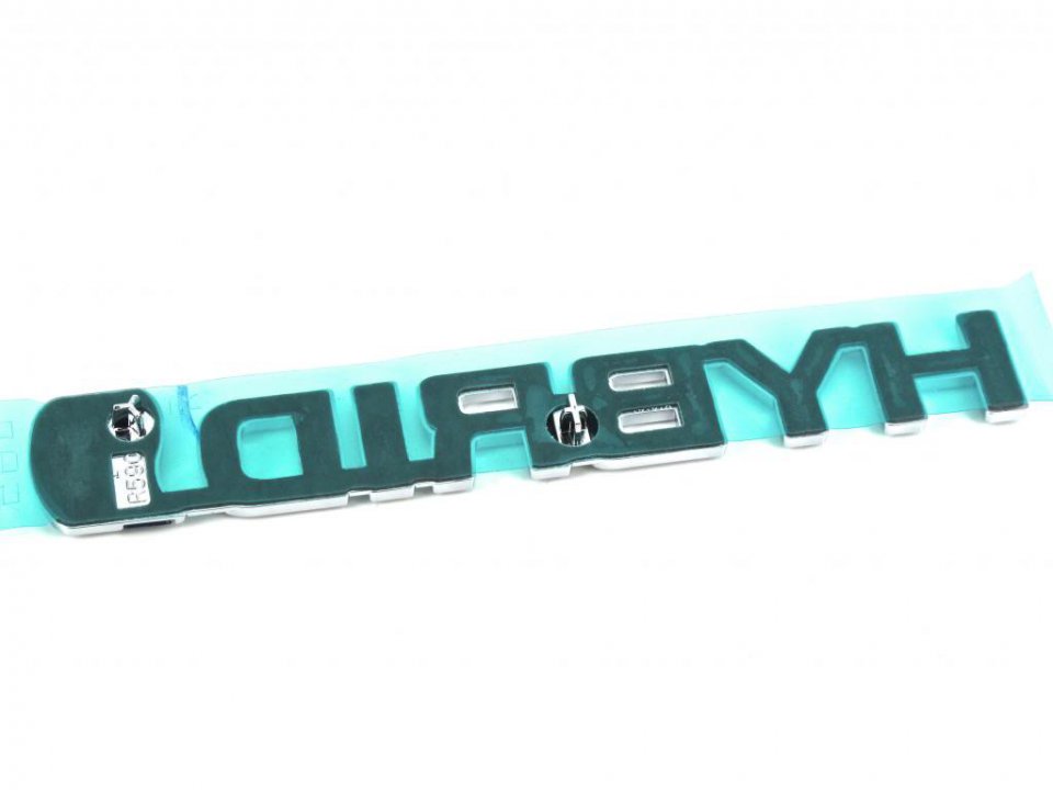

  10. Dylan Doxey
    Dylan Doxey Senior Member
    Mar 15, 2013
    1,389
    3,459
    92
    San Diego, CA
    Looks like he "Hybrid" fender emblem requires two mount holes.
    Tideland Prius likes this.
  11. StarCaller
    StarCaller Senior Member
    Feb 15, 2014
    1,271
    723
    Cedar Crest, NM, USA
    yep, & they are for whatever reason not symmetrical from left fender to right fender /
