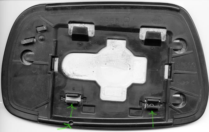

    Look up how the mirror glass is removed and replaced. It's easy: once you aim the mirror as far up as it goes, you can find the two marks one little hole on the lower edge indicating where one of the clips are is. Twist a screwdriver in those two places to release the bottom clips, then hinge the glass outward at the bottom until those top clips can be pulled free.
    Once the glass is removed, you have easy access to the clips that hold the color cover onto the "back" (or is it the front?) of the mirror housing, and you can just push those with your fingers to pop the color cover off. It's easy, you won't break it that way. You might, if you try to remove it without releasing the clips from inside.

    Taking off the mirror before trying to remove the shell definitely helped. Although your picture seems to be another generation. My notch was in the middle.
