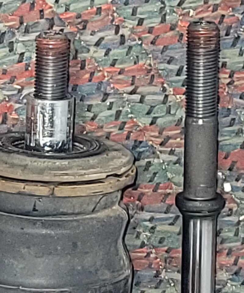

    OEM rear strut stuck in the metal sleeve at the top.
    Any good way to un-stick?
    In my photo, the strut on the left is stuck in the metal sleeve that's part of the protective cylinder. (The one on the right is just a strut) I've played with this for half an hour so far and not found a way to release the strut. (I *need* those parts for the new strut!)

    Visegrip?
    What are the condition of the rubber pieces? Might be worthwhile to just get new ones.

    It's the metal sleeve that is keeping it on.
    Try wd40, then vice grips, not TOO tight, to try to rotate it and pull at the same time.
    And a lot of patience.....

    A three jaw gear puller like the Posilock brand would be ideally suited for this issue.
