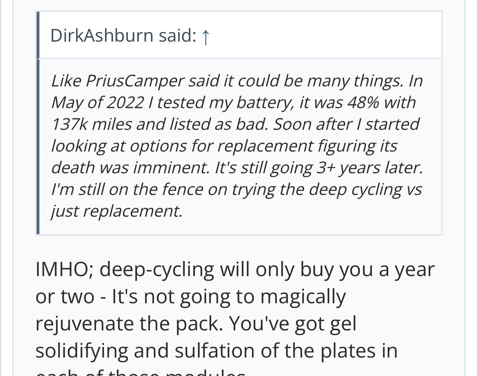

  7. DirkAshburn
    DirkAshburn Member
    Apr 6, 2020
    161
    66
    Virginia
    Like PriusCamper said it could be many things. In May of 2022 I tested my battery, it was 48% with 137k miles and listed as bad. Soon after I started looking at options for replacement figuring its death was imminent. It's still going 3+ years later. I'm still on the fence on trying the deep cycling vs just replacement.

  8. BiomedO1
    BiomedO1 Senior Member
    Mar 27, 2021
    4,598
    2,412
    Left Coast
    IMHO; deep-cycling will only buy you a year or two - It's not going to magically rejuvenate the pack. You've got gel solidifying and sulfation of the plates in each of those modules.
    Your simply going to get less mpg, until you start getting the death triangle. You just need to figure out if the car is worth putting in a new pack. You already know that the gen3 has the worse reliability track record out of the entire Prius line.
