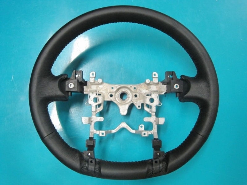

    I'm looking to mod some interior trim pieces. Has anyone had any luck with removing the silver trim pieces on the steering wheel? I was fiddling around with them yesterday, and I think they are screwed onto the two bottom steering wheel spokes (the 5 and 7 position if referencing a clock). I don't want to start prying in fears that I'll break off clips... so looking for any help possible. Thanks!

    You have to take the steering wheel off, the trim pieces dont come out that easy...

    Answering my own question. The shop manual calls for removing the center pad by probing around and releasing some catches to get access to the screws that hold the silver pieces in place, then popping a catch loose for each silver piece. I think I will skip it.

    You have to pull the airbag off and then there are a few screws holding the trim pieces on. You don't need to remove the steering wheel though.

    I recall seeing somewhere on a jdm website and yes you do have to remove the steering wheel and remove the airbag or at least thats what it looked like. I will try to see if I can find that site and post the link. I was thinking the same thing but to change out the led lights behind the controls from green to bright white to match my other buttons.
    I tried to pull them off thinking it just pops out but no such luck.

    It looks like there are two screws on each side.

    It's not that hard to do. 20 minutes max. Here's a video on how to do it:
