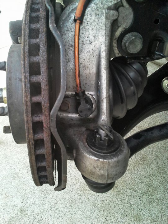

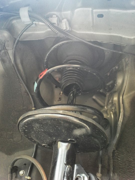

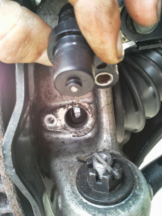

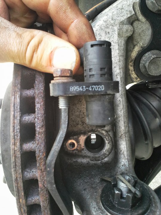

    20130921_135213.jpg 20130921_135451.jpg 20130921_135555.jpg 20130921_135608.jpg
    Ok, I tried pulling the sensor. It looked dirty, so I cleaned it. Otherwise it looks good, no visible damage. No change in symptoms though. The part number is specific to each wheel and they are not interchangeable.
    Would there be any visual indicator of the speed sensor being damaged?
    nh70 - I put the jumper on #4 and #13 on the obd2 port and put the car in Ready. A lot of things were flashing and it seemed too complicated to describe, so I'll take a video and post later.

    ABS 32 confirms that the LH front speed sensor circuit is not working. If you are sure about the other blinks, I don't see those numbers listed. But start with the speed sensor and go from there. The speed sensor is just a coil of wire that responds to magnetic pulses from the spinning sensor rotor (which can be seen at the bottom of the sensor mounting hole in your photos). You can unplug it and check resistance: ~1.4K-1.8K ohms. Make sure that it sits totally flush in its mounting. It won't be affected by dirt. The picture looks OK.
    The connector in the last picture which is unplugged, that is where to check resistance. You could also swap the front sensors and see if the problem goes to the other side, where the ABS blink code would be 31. If not then the problem could be in the harness to the brake ECU.
