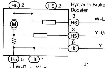

    Let's not distract or misdirect an owner with a serious issue. The brake alarm was sounding. In the diagnostics volume of the service manual on techinfo.toyota.com there will be a table showing which of the possible braking trouble codes are also programmed to sound the audible buzzer. The battery cooling fan won't be one of them.
