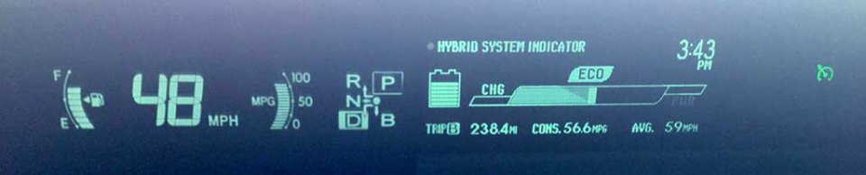

    +1 for the Hakka R2's.
    Earlier today I did a 4+ hour trip on a brand new set and even with no break-in I was blown away by the mileage. Normally I expect to take a pretty big mileage hit when the weather turns cold, even with the all-season LRR michelins. This particular trip covers many miles of winding rather high 2 lane mountain roads and lots of elevation changes (one pass over 12,000 feet and much of the trip over 10,000). Today the temperature for most of it was in the low 30's (f), not frigid but certainly not summer. Having driven it many times in all kinds of conditions I should have gotten an indicated 46-48mpg. Instead I got a rather amazing 56.6! That's close to the best I've ever gotten in the summer. I've purchased various sets of LRR (all-season) tires for both our 2007 and 2010 and they did seem marginally better than the non-LRR tires and most of the time I expect to take a bit of a hit when moving from well worn tires to brand new ones. I also expected a bit more noise when switching out my summer tires for these, but was pleasantly surprised by how minimal the cdifference was. Whatever the magicians at Nokian have done, these R2's definitely deserver their "extremely low rolling resistance" moniker.
    Note that I don't even remotely attempt any hypermiling techniques and am usually one of the faster cars on the road (I pass many people and never get passed). Also these tires happen to be mounted on the rather heavy factory 17 package V rims rather than my much lighter other wheels. All 4 tires were set at 41psi.
    Next test is how they do in snow, but given what others have said, I'm not terribly concerned.
