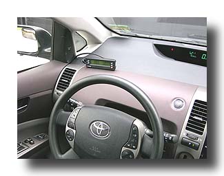

    In the corner is where I installed mine...
    webpage with larger image
    I was surprised how well the wire disappeared into the dash. It effortlessly poked behind the waterseal of the door and tucked underneath the steering-wheel area.
    The location is very handy, almost in your line-of-sight. Yet, not distracting.

    Mine is like John's, only on the right hand side, above the power button, so I can glance at it and the speedometer at the same time.

    Hi John,
    I like the location.. any downsides -- rattles from the buttons... issues with leaving the unit on the dash in the sun... visiblility to passersby, etc?
    Thanks!

    Rattling buttons can be a problem wherever the Scan Gauge is mounted. I got some light weight 1/8 inch foam and opened the case to place it between the buttons and swithces inside. That quiets the buttons, and Scan Gauge should do this at their factory. I think I will suggest it.
