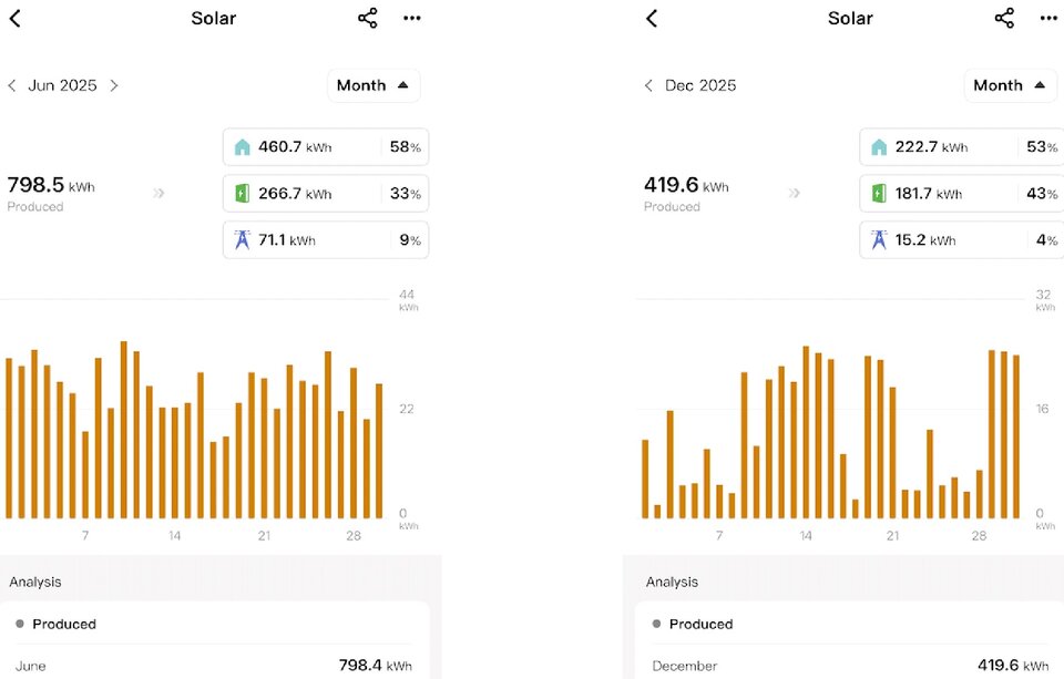

    Looking at Solar, Grid, and House Load for the Summer Solstice June 20, 2025 and Winter Solstice December 21, 2025. Looking at a month gives a 30-31 day sample for each month.
    SOLAR
    • 460.7 kWh vs 222.7 kWh - 683.4 kWh
      • 67.4% = 460.7 / 683.4
      • 32.6% = 222.8 / 683.4
    • Longest Summer is ~2x the Shortest Winter (including one extra day)
    GRID
    • 195 kWh vs 603.5 kWh - 798.5 kWh
      • 24.4% = 195/798.5
      • 75.6% = 603.5/798.5
    • About a 3 to 1 ratio in grid power needed in winter
    • An extended power outage required 2.3 kWh from the emergency generator
    • Grid electrons cost ~$0.12 / kWh
    HOUSE LOAD
    • 883.4 kWh vs 947.7 kWh - almost identical electrical load June or December
    CONCLUSION
    The Summer or Winter electrical loads were nearly identical. The solar production significantly avoided grid load in the Summer and still helped in the Winter. This suggests that adding roof-top, wind powered generator(s) might significantly improve year round performance.
