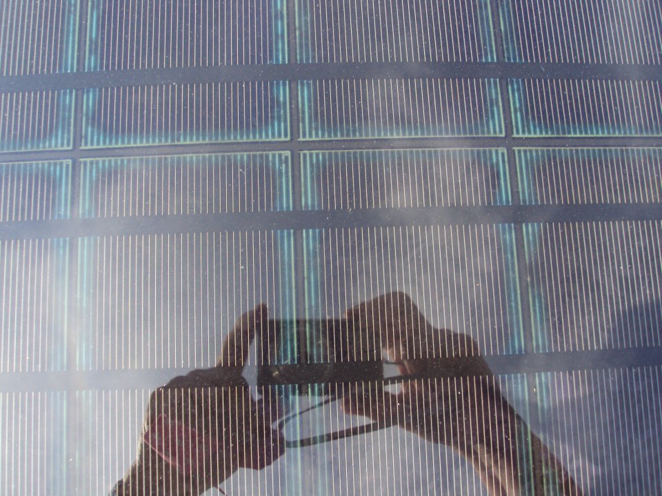

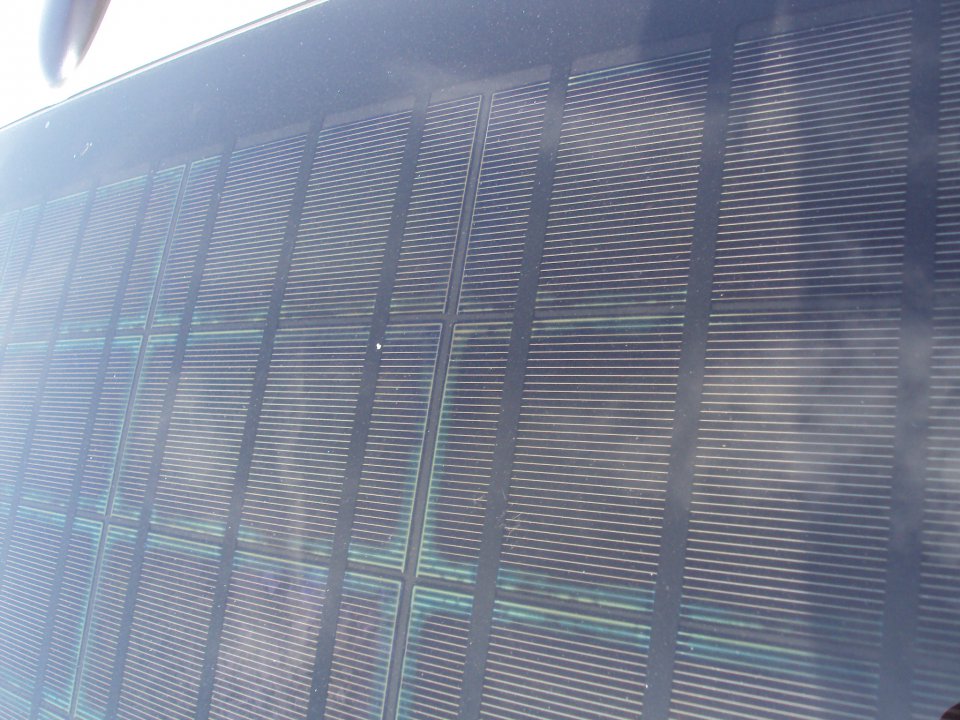

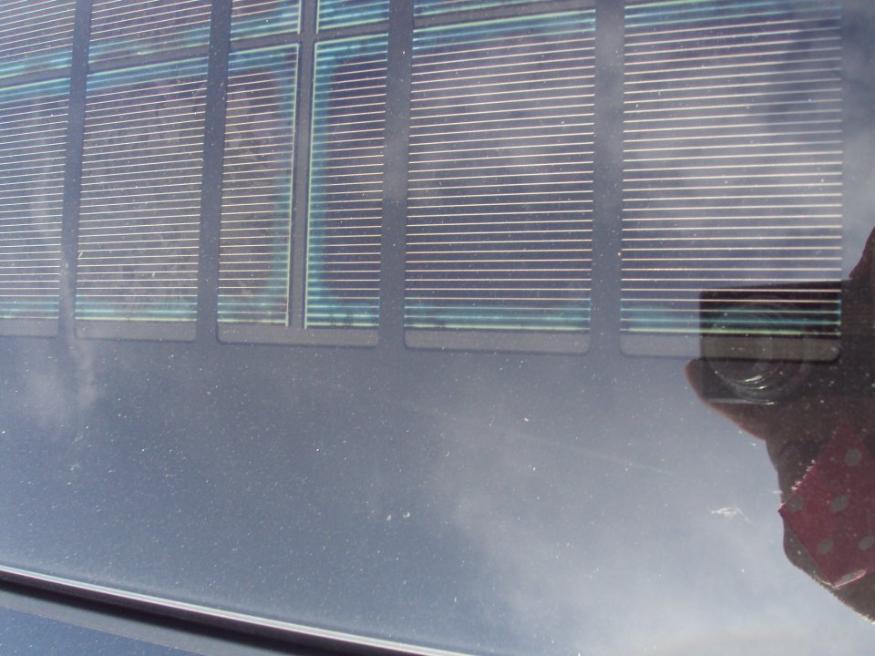

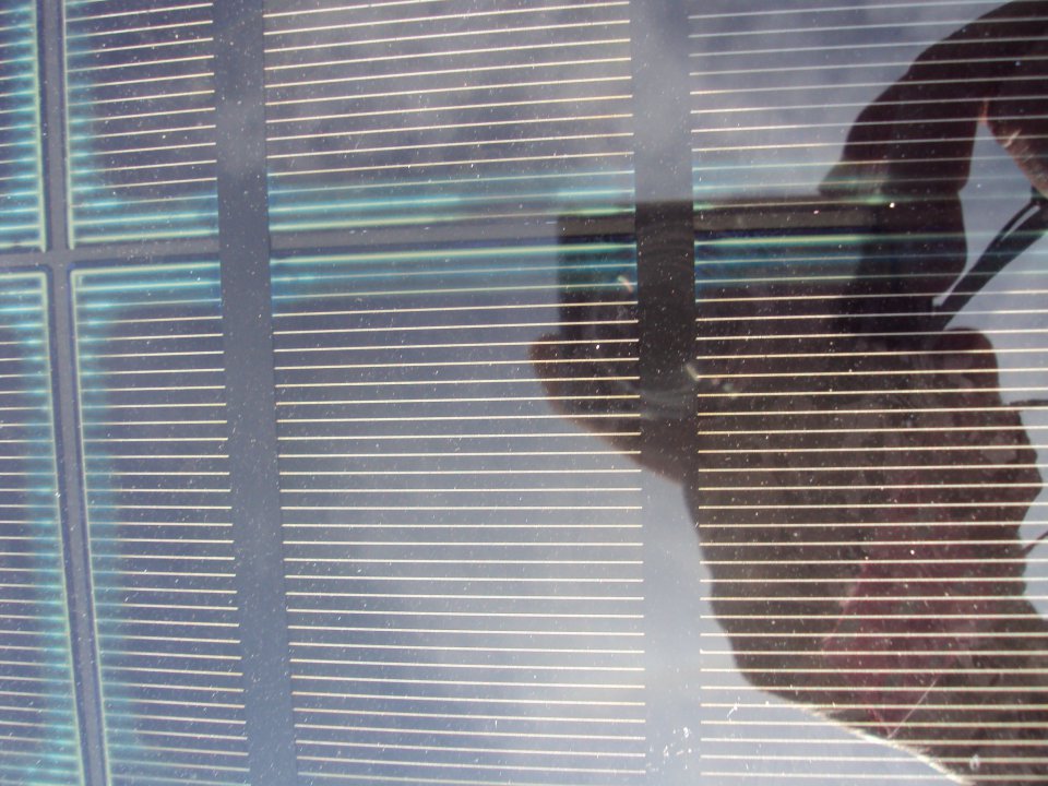

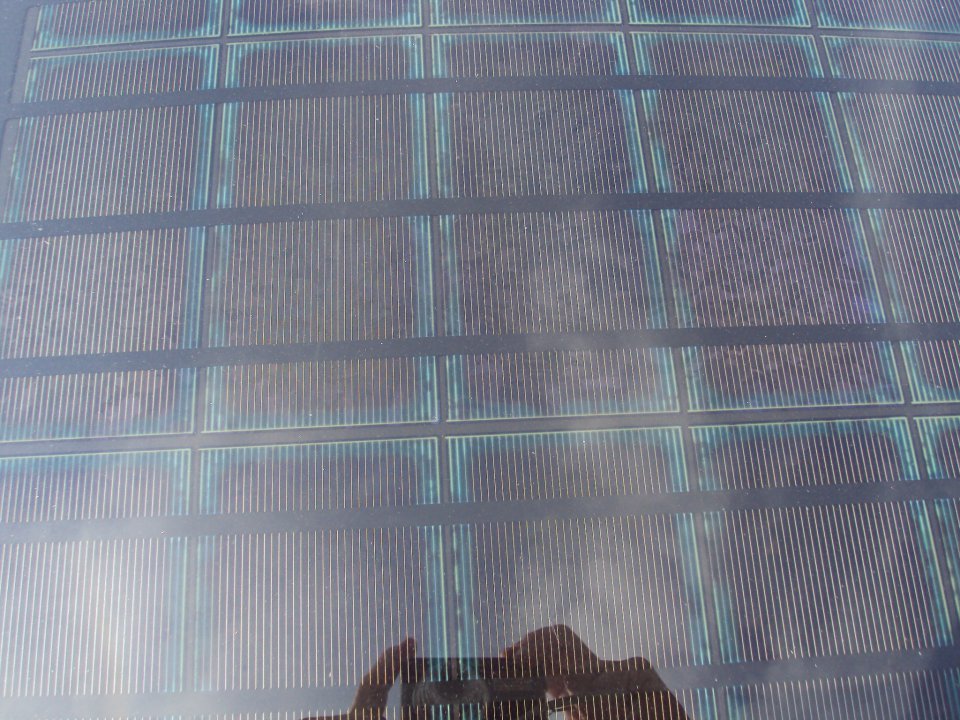

    I am getting a CPO 2010 Prius III 38k miles with the Solar roof package.
    I have some concern with the solar roof on that particular car, the edge of each of those solar panel have some sort of discoloration, it looks like if you drip water on a ink jet printer printed paper. I'm afraid it's water that got into the sealed panel.
    I really like that car and want to get it, I like the pearl white color which is strangely hard to find within 100 miles from where I live. But if the solar roof have problems, I am not gonna get it.
    Those of you have a solar roof Prius, does those panels in the pictures look normal?
    Do you have some similar discolorations?
    P.S. really new here, is this the way to go on posting pics?

    My car is a 2012 and no color similar to that. It may have a broken seal.

    yeah and I recall someone on the forum saying his prius have a solar panel failure, he didn't provide an pics so I don't know how it looks. But he did mention looks like rust on the trace, so I guess this is kind of like that....

    Mine is a year old. No, that does not look normal.
    See if you can get them to replace the panel as a condition of the sale.

    You are right and it does looks like the seal is broken and water got in. I remember seeing something like this on PC awhile ago. I would have the dealer replace it before you buy it. It is under warranty since you are buying a CPO. The dealer will not loose out since it will be warranty work and Toyota will reimburse them.

    A poster on another site stated that his solar panel seal was cracked on a 2010 still under warranty, and it ending costing him $1500 out of pocket. Toyota would not warranty the solar panel since it's not made by them and they claimed that he must have abused the panel somehow. the regional rep was no help to him either. He described the discoloration creeping in from the edges then the entire panel went dead. I'd stay far away from that CPO unless the dealer throws in a new solar panel for free.
