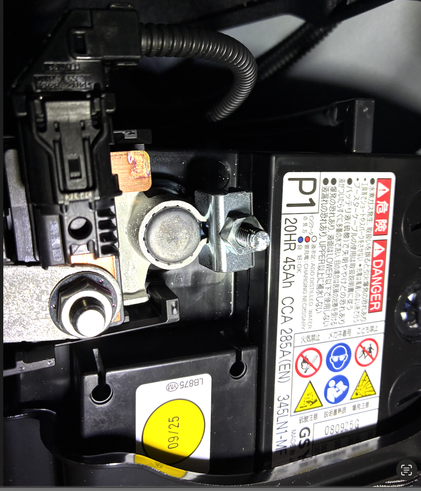

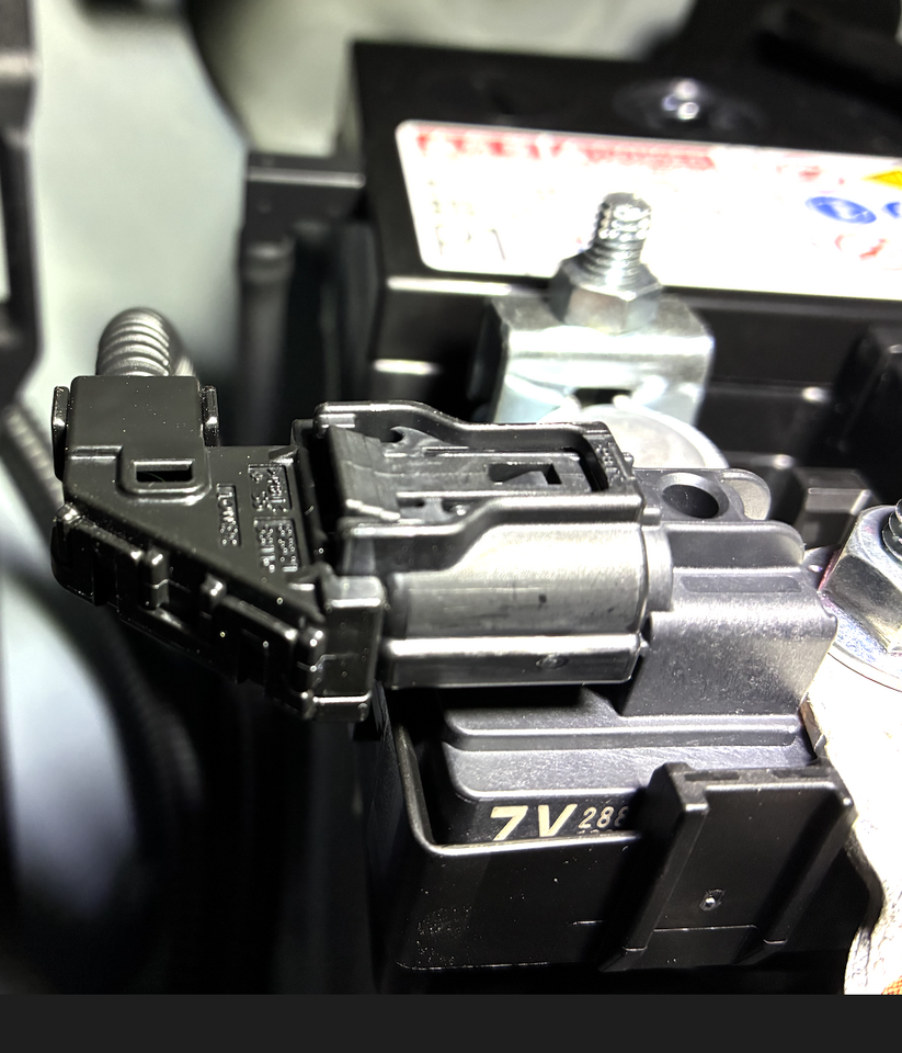

    A redditor just published his findings 3 days ago that disconnecting the 12v negative terminal sensor activates the fail-safe and keeps the 12V charged.
    (go to Heading 5 / page 15 for the solution): Toyota/Lexus 12v Battery Failures - Analysis of Charging Issues - Deep Dive Analysis & Workaround by /u/andy_why - Google Docs
    This looks legitimate but I'm not smart enough to verify his recommendation. Can anyone else vouch for this?

    I read the OP as suggesting to unplug the connector that wires the battery state sensor assembly back to the ECU, thus leaving the ECU in the dark as to the battery's actual state. I didn't read it as suggesting to disconnect the battery.

    Interesting, I didn’t know it was possible to bypass the 12-V battery-management system (BMS) and have the DC–DC converter produce 14.1 V at all times.
    I wouldn't do it myself, but it would certainly solve the battery issues for some.
    The drawbacks: (1) The battery would be slightly overcharged. (2) The fuel economy would slightly suffer.

    No, they are telling to rig the 12-V BMS by disconnecting the connector of the sensor on the negative terminal, not the negative terminal itself. What it does is that the battery is always charged at 14.1 V when the car is in the READY mode. Normally, it is kept at 12.89 V at most times when in the READY mode. This could actually help you, as your battery is always draining.
