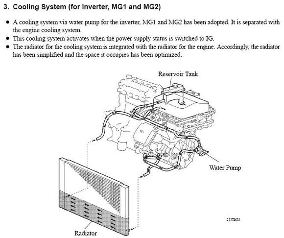

    I would suggest that you monitor the temperature of the interver and MG's if you are blocking the lower portion of the radiator on the Gen II Prius.

    <div class='quotetop'>QUOTE(ScottY @ Sep 15 2006, 08:43 PM) [snapback]320403[/snapback]</div>
    almost all of us that I know that block off the rads or the grill have scanners or CAN-view's to monitor temps. I have a MiniScanner on my Classic and CAN-view on the wife's G2. The temps on my Classic finally got to the range where I considered the winter lips of no advantage in May of this year, and took them out, I'll put them back in probably the first of October and monitor the temps but by then the daytime OAT will be in a range where blocking the grill won't cause dangerous temps. If they do I'll pull them out. Takes only 30 second to put them in or take them out. In fact with the OAT were currently experiencing I could probably put them in now.

    <div class='quotetop'>QUOTE(Frank Hudon @ Sep 15 2006, 11:59 PM) [snapback]320405[/snapback]</div>
    Ok, cool, good to know!
    I want to point that out so that people won't just block their rad/grill without monitoring the temperatures.
