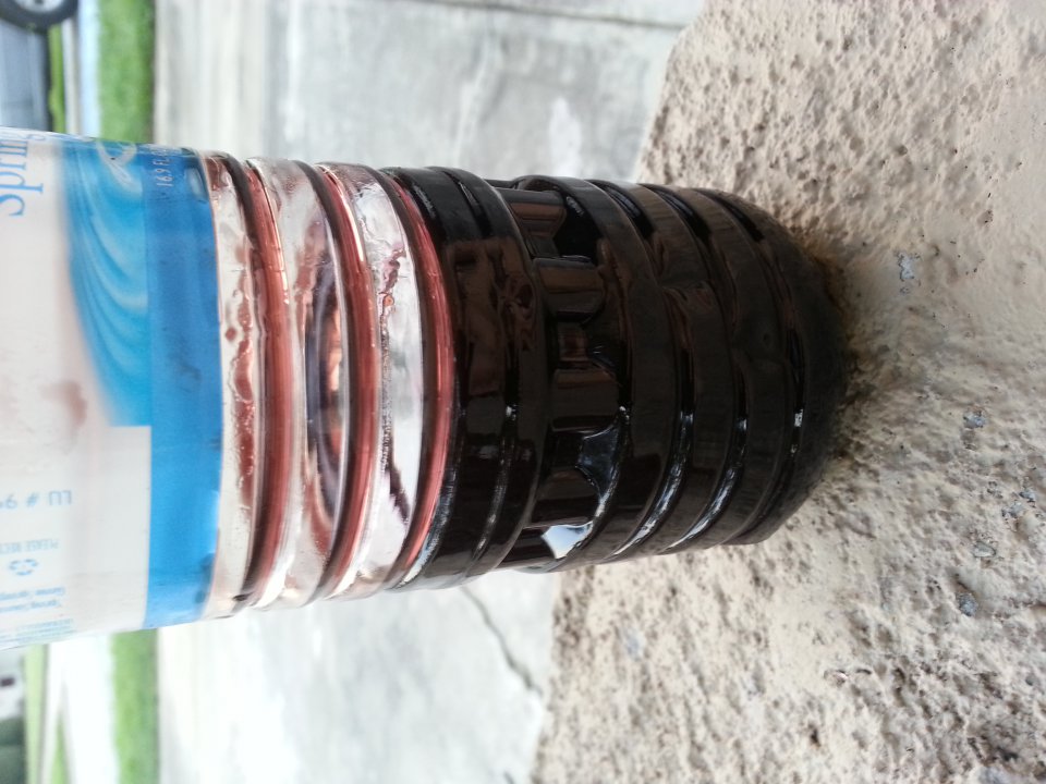

  13. bwilson4web
    28,878
    16,377
    If it isn't too late, did you get a sample?
    A clean, dry water bottle is perfect. It does not have to be analyzed but seeing the condition gives a clue.
  14. Kevine64
    Kevine64 Junior Member
    Aug 9, 2013
    87
    Im gonna dig into it tonight in the garage. Ive got a work light so I should be fine. Ill snap a pic of the fluid in a watwr bottle and post. There are a lot of service records on the carfax but no trans fluid change. The guy at the dealer ship was adamant that the trans had no drain and fill plug when I asked for the new gaskets for tye plugs. Then all the sudden it had just a drain plug. But he finally said he found both. I was told the fluid had to be flushed with a machine lol.....
  15. Kevine64
    Aug 9, 2013
    87
    Well I changed it. Thought I was draining the oil!!!!! This fluid was so bad! No need to have it sent in and tested you can just look at it and tell. Smelled really bad too.
    I got the car as level as I could, used a 2ft level along the weld line where you put jack stands and it was level.
    I spilled about 1/4 of a bottle messing around under the car and i only had 4 qts.... It took all that I had left so id say about 3.75 qts. It never started coming out of the fill plug but I stuck my pinky in the hole and my finger tip was oily so it was just at the fill hole about to come out. Im not too worried, I think I got it right from what ive read some cars taking a touch more than 3.5 qts.
    Im gonna go take it for a 15-20 min spin just to check it out now.
    The plugs were ULTRA TIGHT!!!!
