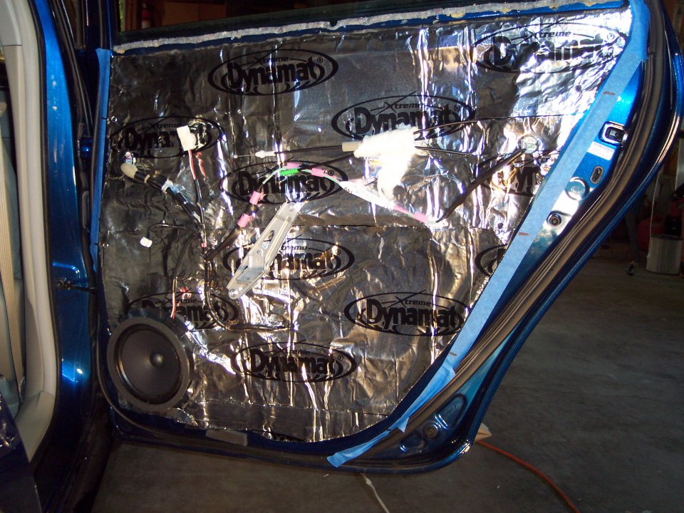

    I did this to all 4 of my doors and the OEM speakers sound great now.

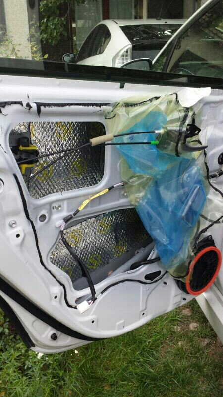

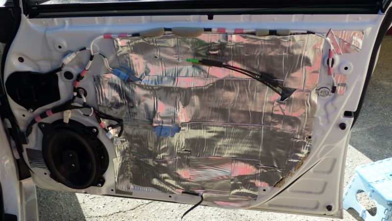

    I have used peel & seal on my outer door skin, covering well over 505.
    I used peel & seal on the inner door skin, covering quite a bit.
    The stuff is really useful for removing resonant noise, just like sound deadening showroom says.
    The reason I used so much on the inner door skin was to cover the clear plastic access panels.
    I can't imagine that having them fluttering around could help the sound of the door speakers.

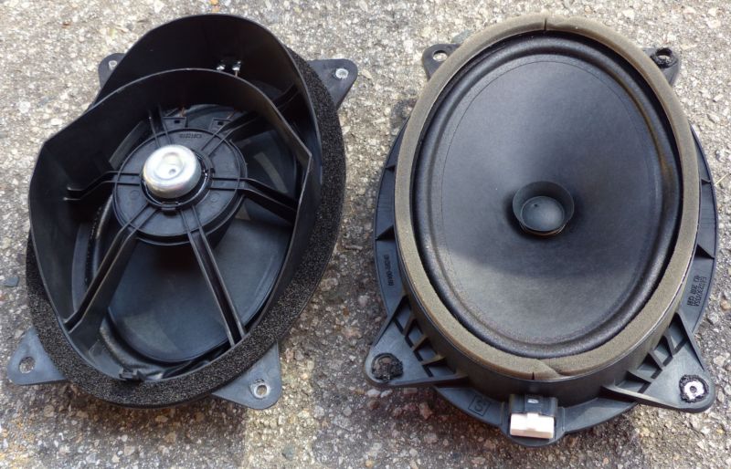

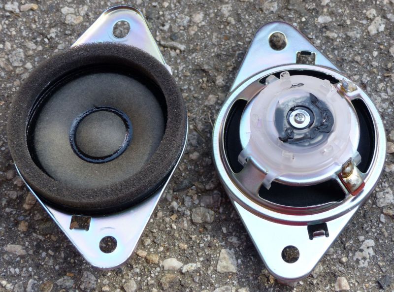

    The factory speakers are really dreadful. I have said so a few times. I am including pictures, just in case you are a bit unclear on the concept. Perhaps SDS meant that OEM speakers are ok if you have a Lexus or BMW. They didn't mean it for a Prius. I bought $50 kenwood 6.5" speakers for the front and rear doors. They made quite a big difference on the front doors, but less on the rear doors. I have now upgraded to 6x9 front door speakers. I don't have a picture of the kenwood speakers, but they are 3 way, not the 1 way OEM speakers. The magnet is perhaps 10 times bigger. The base is much better, the treble is much better.
