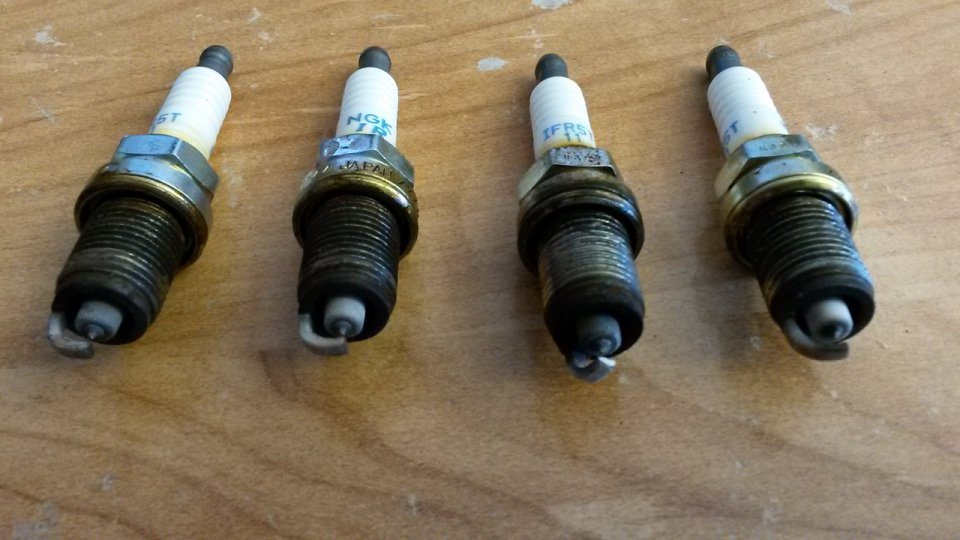

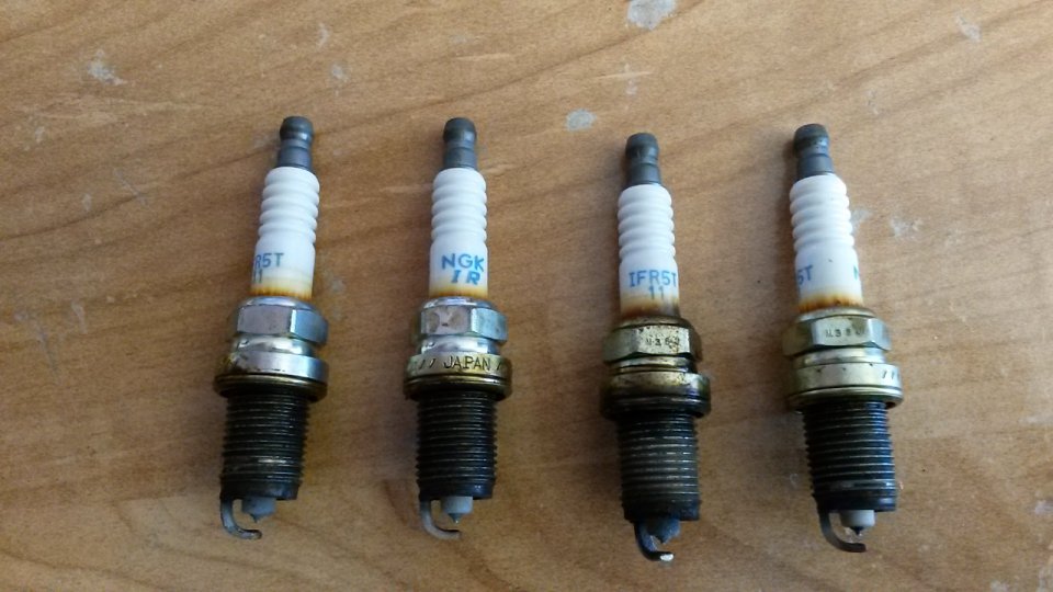

    I just replaced my spark plugs in my 2006 Prius with 170K miles. It's been a little over 40K miles since they were last replaced. Compared to the first pic I posted above, the plugs are getting progressively worse. I did use anti-seize on these plugs, perhaps one of the reasons they look the way they do? Also, it appeared there was oil around the spark plugs where they tighten on the block, could this be the valve cover gasket needing replacement?

    for an engine with 170k miles, those plugs look pretty good

    The third from the left definitely looks a bit oily. Just wondering, what is your oil consumption like at this stage?

    I understand that these spark plugs only have 40K miles of service. If that is the case, they don't look very good, especially the one plug that has a fouled tip.
    Did you use a torque wrench when installing these plugs, and tighten to the correct spec (13 ft.-lb)? If not, maybe the plugs were too loose, allowing HC deposits to leak out via the threads and deposit on the spark plug body.
    I would have the engine compression checked if this were my car.
    Mylar likes this.

    Patrick, I didn't use a torque wrench when installing this set of plugs, but they were not loose when I removed them. The plug in the picture, second from the left, was hard to remove, most likely due to the use of anti-seize on the threads. When installing the plugs I always hand tighten them before snugging them with a wrench. I'm thinking that the reason these plugs look this way has a lot to do with the mileage that I put on this car over the last year. 40K miles in 1 year is a lot of miles. This is mainly city driving over different types of terrain. I have always changed the oil in the car a MINIMUM of 1 time per month since purchasing it in March of 2010. I also use a magnetic drain plug. I think the condition of the plugs reflects the amount of wear and tear that I have put on this car over the last year. I may wind up selling the car shortly, but may just keep it as my business car for now. The car still serves its purpose without issue.

    I recognize this is an old thread, but I just happened across it and wanted to provide a bit of input in case anyone else had a similar experience with the "coloring" on those plugs. The brownish coloring on the porcelain directly above the hex is indicative of this style plug NOT being properly torqued. Although many automobile manufacturers have recommended torque values, most spark plugs that use a crush washer also have their own torque requirements to ensure proper seal. Many of them have the torque requirement printed on the box it's packaged in.
