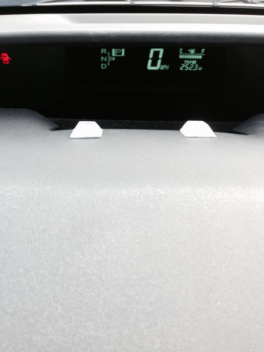

    I have had a squeak in my dash for the last 6 years. It comes and goes. I have tried many things to stop the squeak with no success.
    I was determined to Stop the Squeak. I lightly taped the dash and could hear the squeak. At one time it sounded like it was coming from the drivers side, another time it sounded like it was coming from the center of the dash.
    For some unknown reason, I placed my hand by the speedometer and realized if you stick your hand under the dash , it would lift up a little. I had some rubber pieces and I decided to place them under the dash as shown in the photo. In about 1 minute my dash squeak was gone. Apparently raising the dash stopped the squeak.
    I drove the car, and the dash squeak was finally gone.

    well done sir!(y)

    I applied a similar fix a few years ago using some velcro tape that I had sitting around. My 2010 came off the first boat and the squeaks were ( and still are) really bad.
