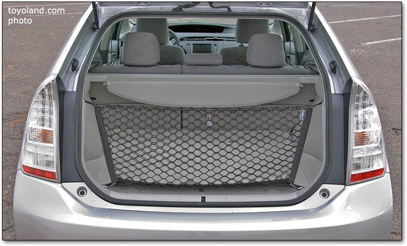

    Here's a PIC of the 2 rubber things.
    Slightly about halfway up the photo, you will see to black rubber things in the rear hatch opening on either side. Just slab some duct tape on these bad boys. I have not heard a sound since.

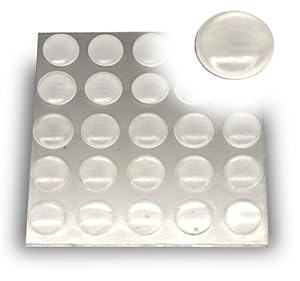

    PS - A bonus fix is the rattling rear license plate if you have a "HEAVY" license plate holder like I used to have. (for example designer Chrome). The fix here was to get a cheaper light weight license plate holder that stays flush to the car. You do not want license plate standing away from body of car. This only makes it easier for it to rattle. PRO TIP FIX: Find lightweight license plate holder that mounts flush. Additionally apply soft rubber (not hard rubber) "sticky bumper pads".
    (clean everything first.) See pic of bumper pads.
    BTW: The hard ones still make a noise but the soft one really work much better. Softer the better. (Keep spares in glove box in one falls off, I lost one so far.)

    If you’re still online, where did you get that rear cargo net?

    That net looks interesting. A while back I bought one from Toyota that came with the two upper mounting D-Ring push pins. Part number PT347-47040
    Works fine but smaller than the one shown here.
