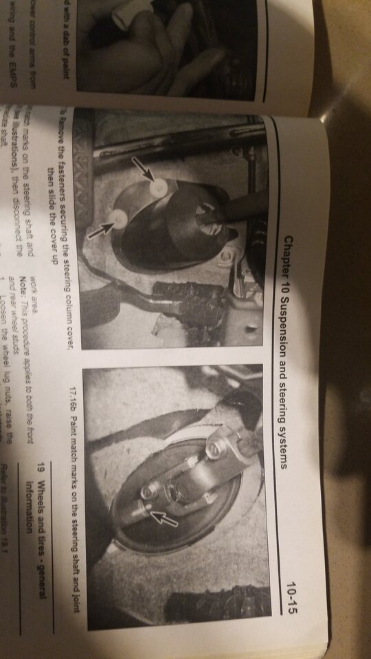

    I'm really struggling splitting the U joint any pointers? I have given it a good blast with plus gas penetrating oil, the nut is out but it doesn't want to let go
    This is my first time doing a steering rack and track rod end replacement but apart from the limited access and this U it doesn't seem too bad

    The u-joint you're speaking of is down by your gas pedal foot or on floor are you undoing that joint outside of car or at the upper joint inside of car all nice n clean ? I think there are two ways to split it. Maybe easier to undo clean bolt .

    Thanks for reply it's inside the car. I just can't seem to free the bar it grips in the lower part of that joint. I suppose I could take out the upper screw and try to take the whole thing out and free it off the car?
    Haynes just says free it 17.16b is where I'm stuck

    IF it's that tite take a large flat head x driver tap into slot that the bolt pinches to hold then use a drift maybe brass to tap the splined hole down to ground. Usually up in the car behind that boot everything is clean you undo the gold bolt take the screwdriver tap into slot near bolt removed should slide down w minimal force
