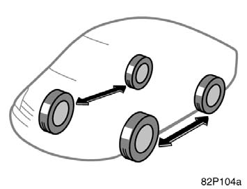

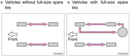

    I did happen to notice three or four years ago that Toyota had changed their recommendation in the owners' manual, between Gen 1 and Gen 2:
    Gen 1
    Gen 2
    Gen 3
    Gen 4
    I still like the way the Gen 3 illustration carefully shows which way is "front", as if it would make any difference in that pattern.
    FuelMiser likes this.
