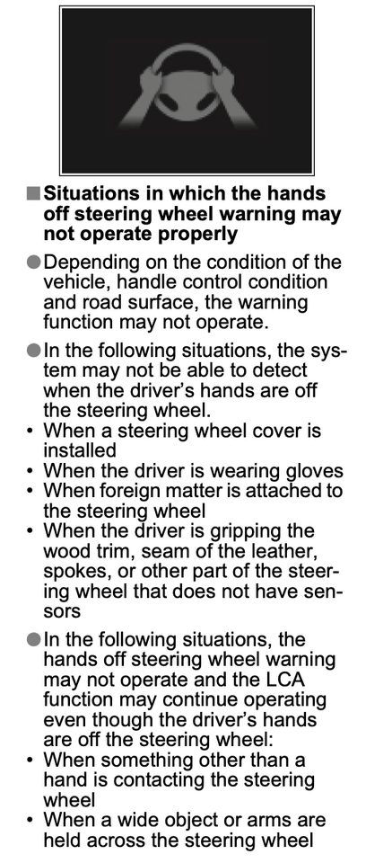

    So, I'm up to page 250 or so of the manual.
    Some component, LCA(?), of Toyota Safety Sense seems to want bare hands on the steering wheel, ie, no gloves.
    Would this preclude an aftermarket leather steering wheel cover, if you wanted the LCA and/or no warning buzzers/lights?
    My car will be a DL, without LCA, or steering wheel heat, lol.
    I found no other mention of the bare skin on wheel requirement for the other Safety Sense "features" the DL has.
    But I could be wrong.

    I should think that any steering wheel cover would impair the capacitive touch sensors in the steering wheel.

    Would it matter if you didn't have the LCA "feature"? Does anything else depend on them?

    Cars with LCA (ie PHEVs/Primes in the USA) have the capacitative touch sensor in the steering wheel. Others don't. So that warning doesn't apply to your car.
