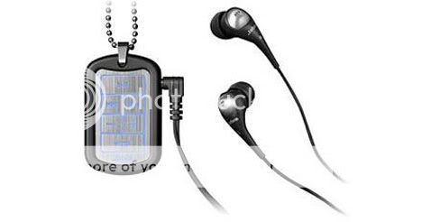

    On another forum that I frequent, people have reported success with the Jabra stereo BT headset that looks like dog tags. Just get a patch cable to connect the dog tag to the aux-in, and you can stream music to it wirelessly.
    http://www.amazon.com/Jabra-BT3030-Bluetooth-Stereo-Headset/dp/B000XT3L7W
