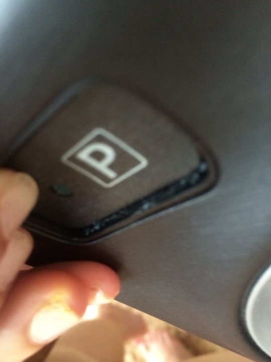

    A glow stick broke and the fluid fell into the park button yesterday. The park button has gotten progressively difficult to push today. Once I get the console off how do you know how I would get to the park button? Judging from the video below looks like there are things to disconnect? I am also wondering how I should clean the button...was going to use rubbing alcohol?
    Lesson learned, don't leave a glow stick necklace hanging on the rear view mirror in a hot prius... urrggh
    Thank you for your help!

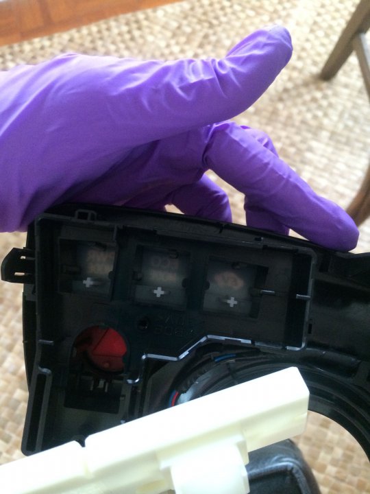

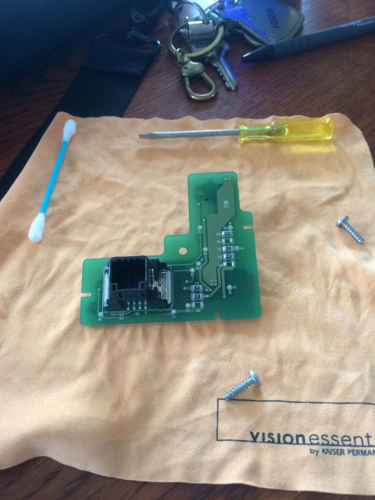

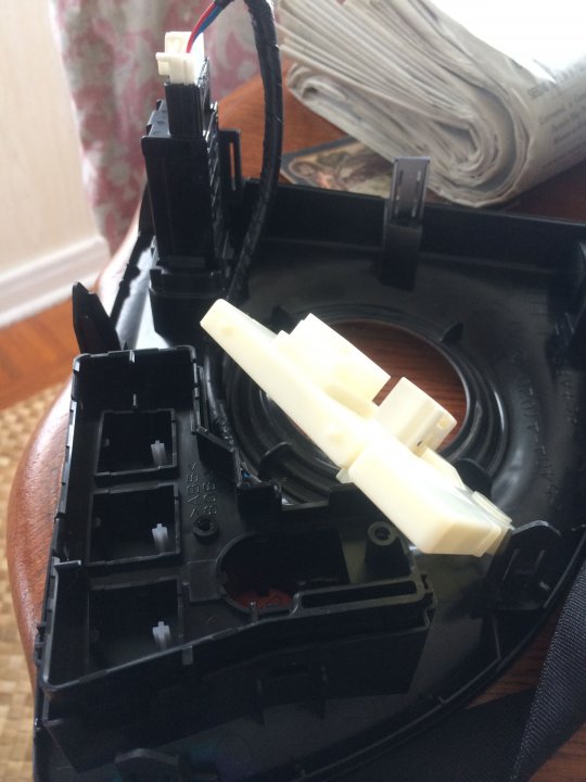

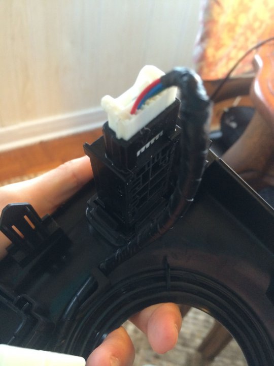

    After work today I was able to pry the console off, it was a little challenging at first but once I got off the upper left corner of the console it was easy to get off. I couldn't get the park button electrical portion to snap off like the hazards and EV Eco power drive did. See photo below.
    Not sure if the park electrical portion is supposed to be able come off?
    I used CRC and rubbing alcohol and a qtip and a hair dryer with cool air on high. Thank you for all of your help and suggestions. I added some pics below so you can see what the inside of the console electrical looks like.
    FYI : ) I stopped by my mechanic and he told me to take it to the servco when I called the servco they told me to go to a car detailer.
    Thank you all again! When I reinstalled it this evening the sticky button problem seems resolved.
