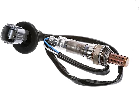

    Stolen cat on our 2004 Prius. I bought ebay item 193690871378 and amazon item B000C5WCUO per recommendations on this site. (Thanks a million, all y'all!) (Not allowed to post links, sorry.)
    I didn't like the "for Calif. Equip" part of the O2 sensor description on the Amazon listing because I don't have a CA Prius, but it worked for AndyFromWI, so what the hey? (I also didn't like that the description says "Square Plug Harness" while the image is of a rectangular plug.) It arrived and the plug is square, as is the existing receptacle. Sounds like a win. Unfortunately, the plug and the receptacle will not mate. Insertion is possible, but there is no click connection and the depth of penetration doesn't seem adequate for physical contact between the two parts. Any idea what gives?

    Image credit: Amazon (Error message trying to use "Upload a File," so none of my own pics yet.)
    I know for a fact a small bit of the square plastic connector on the stolen sensor broke off. Quite possibly something also broke on the car side connector; I just can't be positive yet. It certainly doesn't snap together. I made one unsuccessful zip tie attempt today (had to move the vehicle before I could finish). I'll have another try when I have daylight again.
