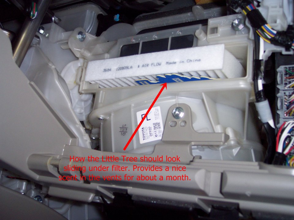

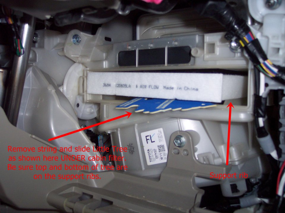

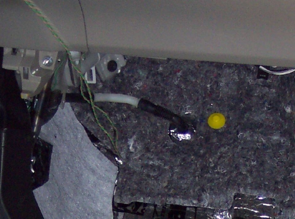

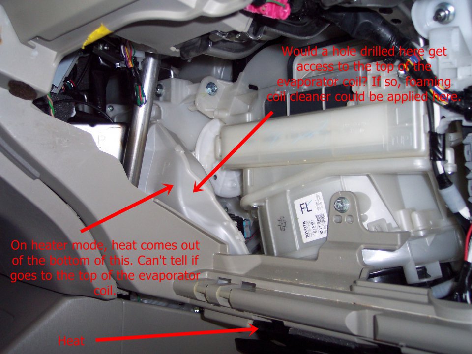

    Here are some shots of the area I suspect the evaporator coil box is located. I've also included a pic of where the drain tube is as I located it during my Dynamat project. How I solve the vent odor problem is to cover it up with a "Little Tree". It works for about a month.
    Maybe The Critic can confirm if drilling in the area I suspect is near the top of the evaporator coil, it would be possible to inject coil cleaning foam using an plastic extension tube followed by a rinse. Fan and filter box 001.JPG Fan and filter box 002.JPG Fan and filter box 003.JPG Prius G3 evaporator coil box drain.JPG
