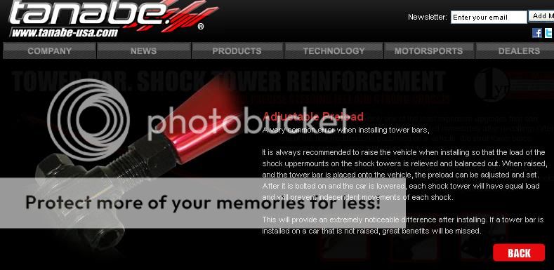

    From Tanabe's website. Make sure the car is raised during install for it to actually be functional

    Thanks for this reminder, not quite sure why unloading the strut upper mounts and towers have to do with improving performance but since the manufacturer advises, I will do it.
    I will install the brace after the weather improves around here, soon I hope. My thoughts to purchase and install NF210 springs at the same time may delay the installation further.

    I just checked my strut brace for preload. If you follow HAWAIIANBUILT's instructions found elsewhere in this forum, there's no mention of preloading. I raised the front & put in jackstands on the sides, then I loosened the brace end bolts. I could get them out fairly easy, so the brace wasn't really tight. After putting the bolts back in, I realized that by rotating the top of the brace forward, I could "pull in" the ends and put pulling tension on the strut towers.
    I rotated the brace as far as I could by hand, then used a rag-wrapped wrench to rotate it a bit more, then I tightened the jam nuts on the brace bar ends. I'll go see what difference this makes on the road.

    Did raising the car and making these adjustments have any effect for you in the way the car handles? Please let us know. I'm planing on installing this brace and would like to know if I really need to raise the car for the installation. Thanks! :)
