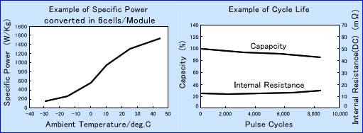

  18. efusco
    efusco Moderator Emeritus
    Nov 26, 2003
    19,891
    1,196
    Nixa, MO
    Here's an informative graph showing how the cold affects battery performance. Thus, keeping the battery warm (via garaging?) improves it's performance/efficiency and can improve your FE.
