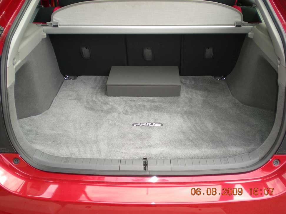

    Here is how I did mine. After 3 years, it still thumps just fine, but then I do not overdrive the piss out of it.
    Mans got to know his limitations!:cool:
    It works very well, out of sight, secured to the HV battery cover! The plastic, not the metal!

    Very clean install. Looks nice. Did you make that cover around the amp and sub or is it available in the market?

    All the work was custom! Thankfully I have tools! I also have access to a nice metal shop , with a Bridgeport mill! I made the custom corner mounts on the mill, they came out sweet
    It looks simple and plain, which is the look I wanted, sounds great, and is mounted securely however!

    That's a nice setup. I like the box, I hope it doesn't rattle!
