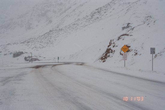

    Normal day on one of the passes on the continental divide:
    And rather "good" road conditions on another pass (Loveland, not my photo)
