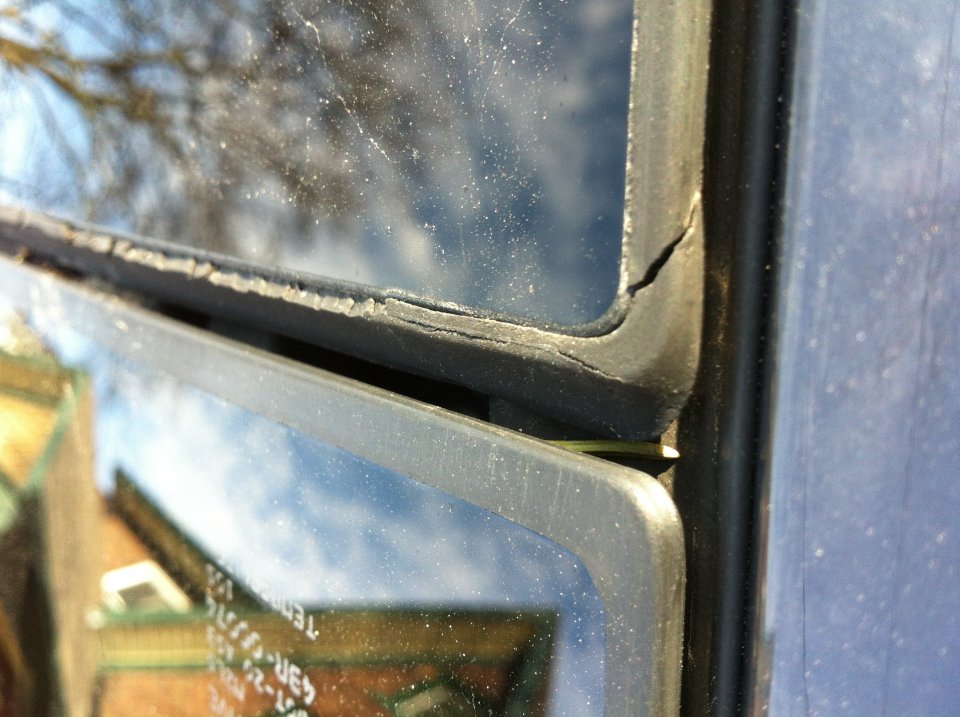

    Here's a strange one...
    Model Year 2010 Prius, rubber along the front edge of the sunroof glass looks dry/cracking, but only on the left side of the car. Don't think it has anything to do with the location it is parked in, as that and the orientation changes daily.
    Has anyone else seen this? I'm at 104 000 km and haven't approached the dealership yet, but that's my next step, to see if they'll still cover repairing it.
    Thankfully this will not result in leaks, it's just cosmetic - the sealing surface is on the bottom of the glass, the big air-filled donut.
    -Iain

    I had the same, and it was replaced under warranty. They have to remove the headliner, so I've got some rattles that weren't there before, and the roof clunks a little, as if it's not quite aligned correctly. I imagine it would be an expensive change, so consider carefully if they're not going to replace it under warranty.

    all rubber needs some kind of protectorant from when the car is new and this wouldn't happen, if you were using ArmorAll or simular product then it is likely defective material!

    Ok, i went to my toyota seller, and they removed the sunpanel and the glasroof och replaced it with new parts on Goodwill. My car is from late 2009.
    Price: sunroof+glasroof+work (20000+7000+8500) total: 35500kr (swedish Krowns) $5400.
    I payd 0:-
    Well se how long the rubber will hold this time.
    tcdp3 likes this.
