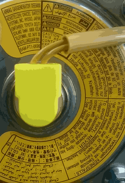

    Thinking that 14 years of hot days/cold days might not be desirable in that case, for peace of mind I've dug into my Gen 1 and confirmed the driver and passenger airbags were made by Daicel Safety Systems, not Takata. The driver's inflator is a straight pyrotechnic one:
    ... while the passenger inflator is a "hybrid" design: it has a canister already containing a highly-compressed gas (behind a rupture disc), and a pyrotechnic charge to make more gas, drive the pressure up, and rupture the disc. (The passenger-side inflator has a much bigger bag to fill.)
    Their model numbers and BAM (German Federal Institute for Materials Research and Testing) registration numbers are shown on pages 73 and 81 of this BAM registration list, but I was hoping it would say more about the propellants used, and it doesn't.
    They've filed a ton of propellant patents over the years, but I'm not sure how much peace of mind that gives me, because in the years shortly before the Gen 1 came out, they had at least one patent for a propellant that doesn't use ammonium nitrate, as well as another patent for one that does. :unsure:
    Not sure how to learn more about what propellant they ended up using in these exact inflators....
    -Chap
    Another thing you can do with off-the-shelf, automotive airbag hybrid gas generators: launch torpedoes better.
    I was trying to find something, anything, that would say what the intended shelf life of a hybrid gas generator is supposed to be, and that was the best reference I found. Says it should be "at least twenty years" and the automotive airbag standards "exceed military standards for reliability."
    As one more interesting factoid, it says one typical hybrid gas generator produces "about twenty-five kilojoules".
    -Chap
    Hmm, Daicel's DEE5000 (the steering wheel inflator) seems to have been pretty popular, with 31 auto manufacturer customers in Germany (see pages 250 through 253).
    The DHD5002 hybrid generator for passenger bag had 9 auto manufacturer customers there (pages 59, 60).
    -Chap
