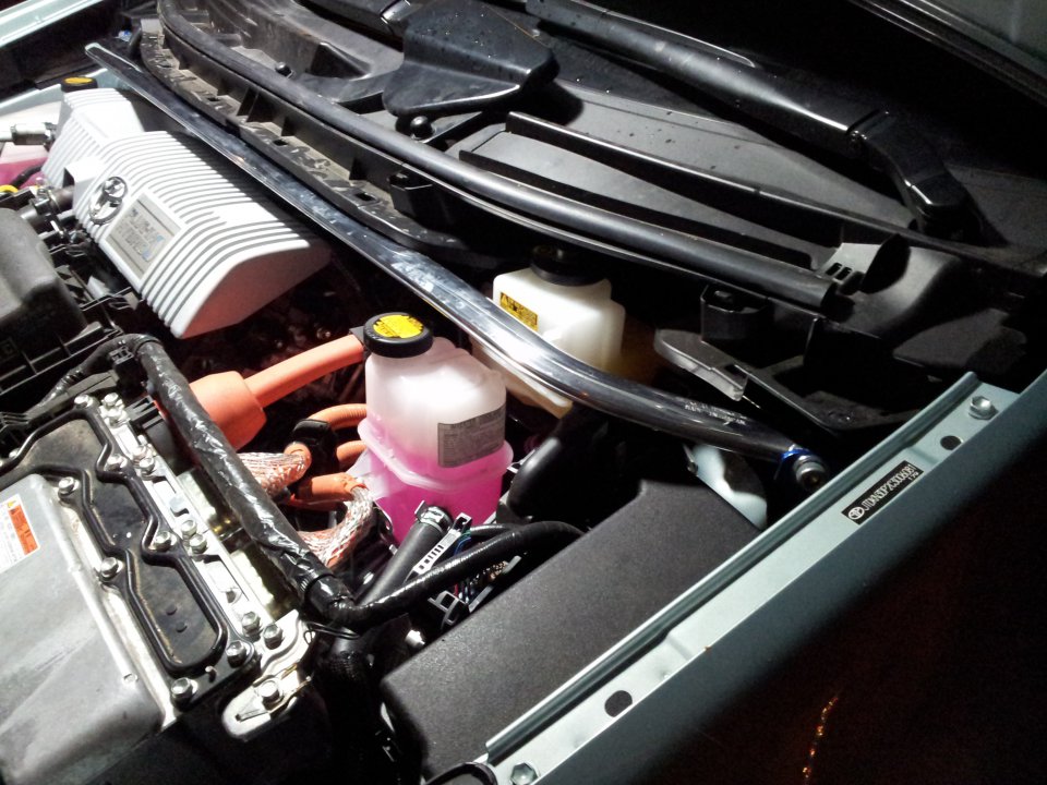

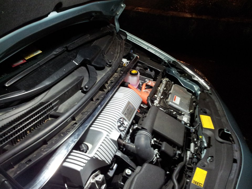

  17. DadofHedgehog
    DadofHedgehog Active Member
    Jun 17, 2012
    681
    282
    northern Virginia
    My Cusco after Fall 2012 install.
