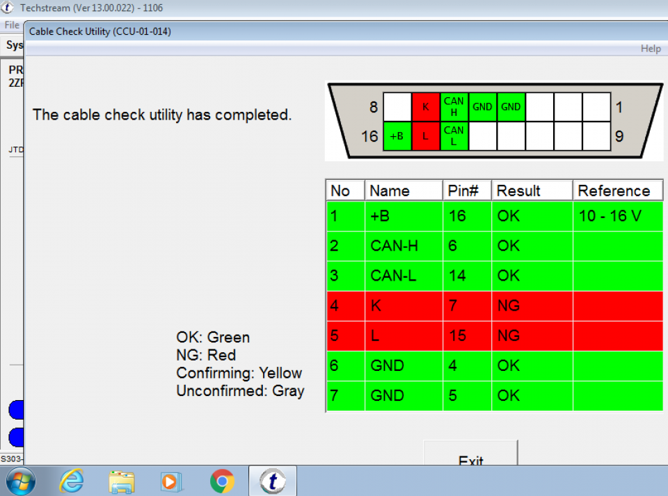

    It does have a VIM check feature somewhere, that can give you a picture like this:
    But I think if your VIM is unable to do something, typically Techstream will just let you try anyway, and put up an error alert when it doesn't work.
    It's also possible to download the DrewTech J2534-1 bus analysis tool and use that to put your dongle through its paces and see what you see.

    That is the DLC3 cable test which is is under "Help". The result on mine was just like what you posted above. I am not a fan of that test! It never completed any test (that is, changed from the "confirming" to "OK" state) by itself. At each step I had to count to 30 then press "next" and then the state changed. Also, there were messages about putting ECUs into and out of reprogramming modes, which was not something I wanted it to do. Those were associated with the failed tests. Hopefully shutting the car off cleared any of that which might have gotten through.
    Techstream 12.10.019 was uninstalled, all the Denso stuff it had installed was removed too, and the driver. Then the registry was scrubbed with ccleaner and the disk was checked for files with "techstream", "toyota", and "denso". There were none of the latter files and the former two were only found in the software installers still in C:\temp (and links to it).
    Reinstalled everything, and it was just as before.

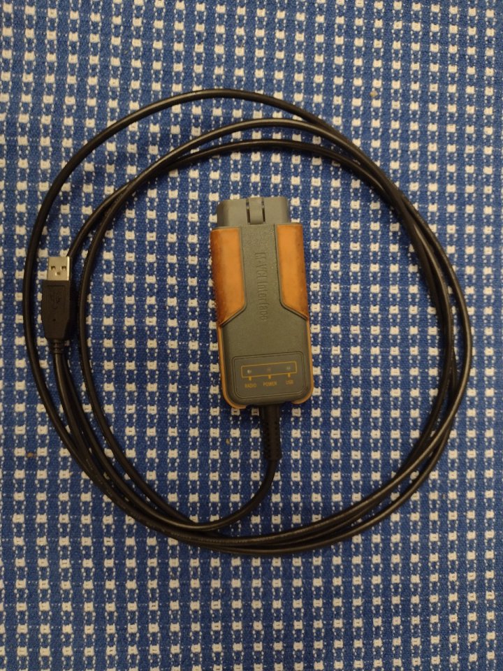

  12. mr_guy_mann
    mr_guy_mann Senior Member
    Sep 3, 2020
    3,529
    1,611
    NJ-USA
    Yep, got an "original" XHorse many years ago- still use it when I'm at home. The first clones looked like the original - but after XHorse stopped making them the cloners didn't bother keeping the look when they could make them even cheaper by using the clear housing.
