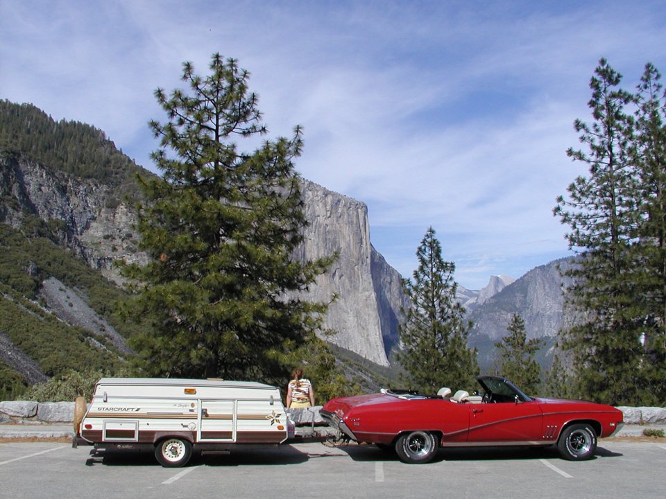

    Ouch! Have you ever worked on cars? Ever done any body work? That is an amazingly hard task to take on, and you may end up with two piles of wrecking yard fodder. Even just the body of that Firebird will weigh probably twice as much as the Prius body. Plus the frames on the convertibles are strengthened to counter the body flex potential for no integral roof support to the car. Nope,, Not,, I will follow along, but seriously am a doubter. A very big part of the fun of driving a convertible "muscle car" is the "muscle part"! I would say fix or buy a newer Prius for a daily driver, then re-store the Firebird close to stock as all those parts are available re-manufactured, or slightly modified from another "A body" GM car. Unless your a true master craftsman, you will be throwing money away! I know, as I own a 69 Buick Skylark Conv..
