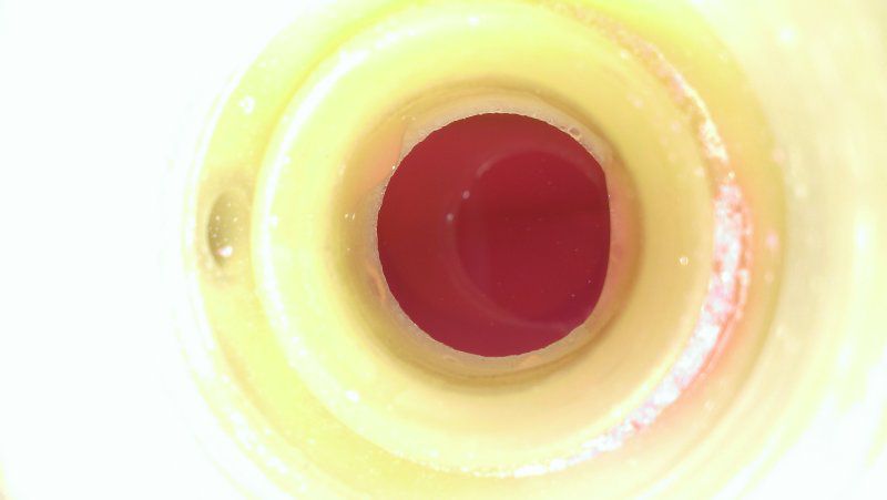

    First time I see an error code 7.5 years into the car. Scanguage read them and I cleared them (successfully for now)
    What should I worry about? A/C lost power a couple of minutes before the errors started blinking. No other weird behavior noticed, no recent services other than an oil change.
    Thanks a lot!

    Exactly what warning lights appeared?
    That list does not show valid Prius codes. You need something better, Mini VCI for example.
    Check the inverter coolant reservoir for fluid turbulence when the Prius is READY. If you don't see this, the inverter coolant pump has failed and that is the root cause of your car's problems.

    I recall that the check engine light and the red triangle light appeared, that the lcd screen was showing a red triangle at the top, and that the cabin lights and headlights dimmed. All that happened in ready mode.

    ~69,000. This morning there were no lights, but this liquid had minimal flow/disturbance when I looked at it. I think there was a recall on this pump?
    Can I drive her 5 miles a day for a week or so before I fix it?

    Pump's shot; should look like a bubbling stream in there.
    Yes, there is a TSB for the coolant pump...read here:
    Luscious Garage | Blog | Prius Code P0A93: Inverter Water Pump Failure
    Any miles a day like this is a bad idea....overheat the inverter = $xxx repair bill if you DIY, or $xxxx bill at the shop.
