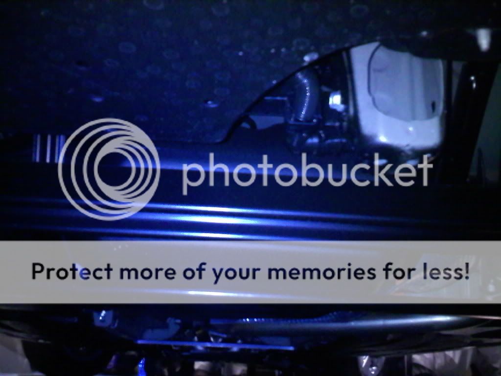

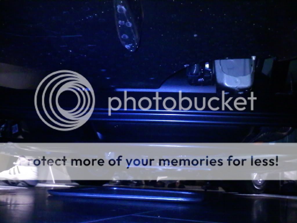

    Way to go Brian for filling in the gap till Toyota finally got the message!
    Boy, did Toyota hear!
    After looking under the 2010 Prius, its quite obvious with the bar and beefy brace that runs across the whole width of the car in the back, that the flimsy stock brace did in deed did need fortifying to improve the ride.
    I think the 2010 prius substantiates the BT stiffening plate.
    I"m sure the BT Plate did not accomplish all that the new parts do now on the 2010.. but I think it proves there was some stability issues that the BT plate definitely improved.
    Not trying to start the fur flying since this has been a hot topic in the past, but just wanted to bring out the point that although the plate will not be needed for the 2010 and later prius's, it appears to have something going for it for all earlier models or Toyota would have left good enough alone.
    These pics aren't very good, but its the best my little phone camera could do.
    The round brace (3/4 or an inch") is in the distance more, while the thick brace that must be close to 4 inches wide is closer in view.
  2. Patrick Wong
    Patrick Wong DIY Enthusiast
    Mar 8, 2008
    18,200
    6,493
    Green Valley, AZ
    The following photo comes from post #9 of the following thread which provides a link to better photos of the rear of the 2010:
    http://priuschat.com/forums/2010-toyota-prius/58385-few-pics-chicago-event.html
    Now that we have a better photo to look at, we can discuss the rear suspension.
    First, note the inverted tower that protrudes down and serves as the floor jack jacking point to raise the rear of the car.
    Immediately behind that is the beam axle for the rear wheels. The beam axle does appear to be more substantial than that found in Classic and 2G.
    The rear suspension bar is tubular and located below the beam axle. In Classic and 2G the rear suspension bar was within the beam axle.
    Way in the distance, you can see the equivalent of the BT plate for the 2010 model, under the exhaust system, attached to the body.

    The facts don't support your assertion. Toyota obviously felt that the rear suspension could be improved, because the 2010 has an entirely new and more robust rear end. That part is a fact. However, from that fact there is no way to extrapolate that the BT brace did anything to help with the existing model. You can give them credit for recognizing that a problem existed and for trying to do something about it, but you can't logically assert that it actually did any good.
