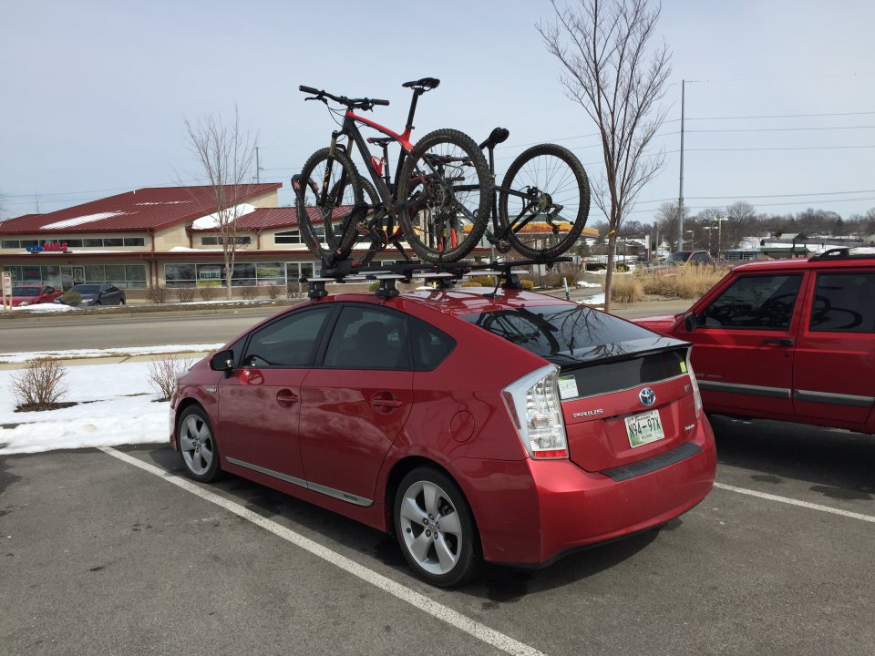

    You should be able to easily fit two bikes+separated front wheels on the roof rack--just follow this guy's example:

    FWIW, I've got 54" Aerobars and a 526 fork-mount tray. Sometimes, my sons and I add their two Yakima trays (one fork-mount, one upright) and we can fit 3 bikes up top. The one trick is mounting the center bike backwards so the handle bars fit better.
    Haven't seen any issues w/ the hatch clearance. It's close ~3", but works fine. The biggest down side is 43MPG and noticeable wind noise. But that's still twice the best mileage of our Odyssey van loaded up, so it's all good! ;)

    You're welcome. Yes, crossbars mounted per spec for Gen III w/o sunroof. Honestly, didn't know T-mounts were an option. Happy w/ what I have now, but will look into them to learn more. No stability issues--definitely felt the wind drag w/ 3 bikes. And being passed by trucks and buses did not go unnoticed, but never felt uncomfortable or uncontrolled. Had this setup for a year and no apparent damage so far. Took them off for a few weeks in winter and saw no rust or scuffing. Best rack I've used since my Saris roof rack from 1994!
