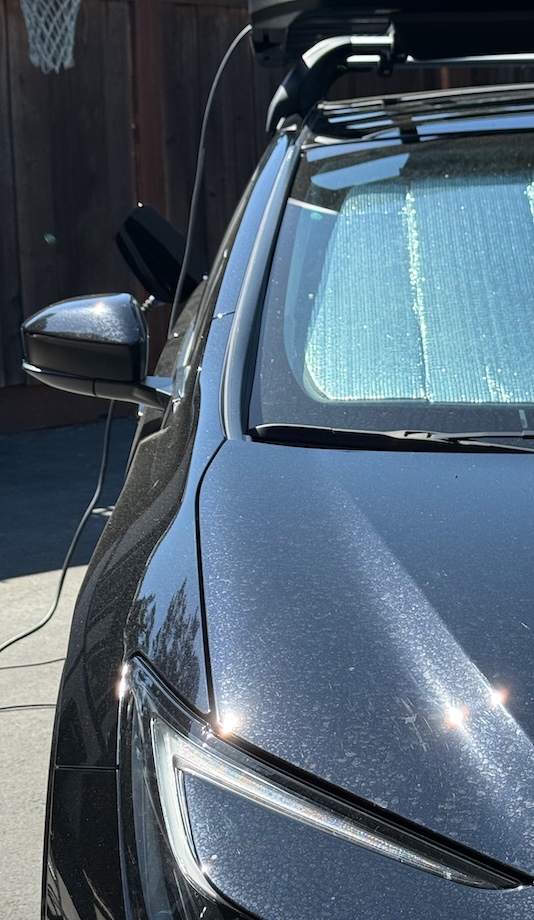

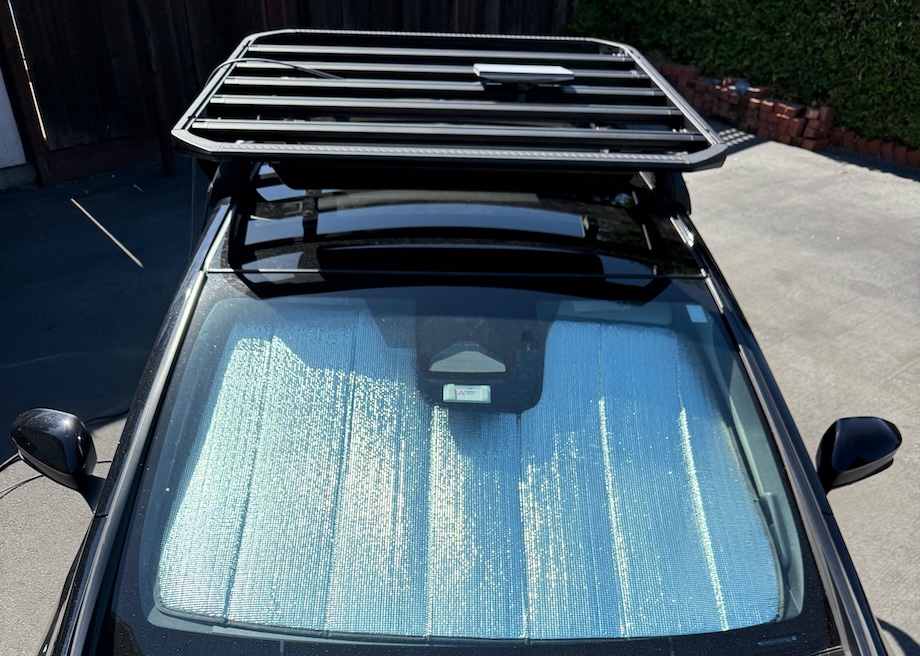

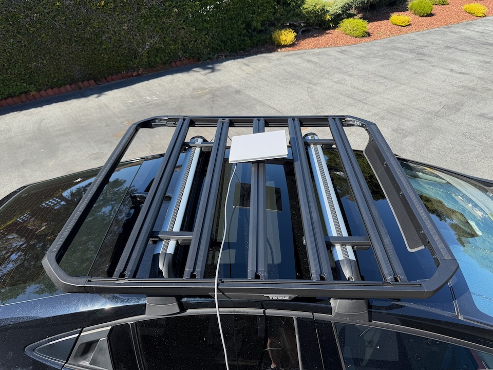

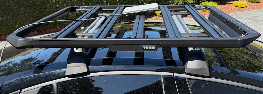

    I installed a small Thule Caprock on my Genuine Toyota Crossbars. I am attaching some photos to give an idea of what it sits like on the prius. Gives me a place to store my spare for long raod trips and makes it easier to attach many other accessories to the roof. Hoping it doesn't have too much effect on MPG.
    Photos -

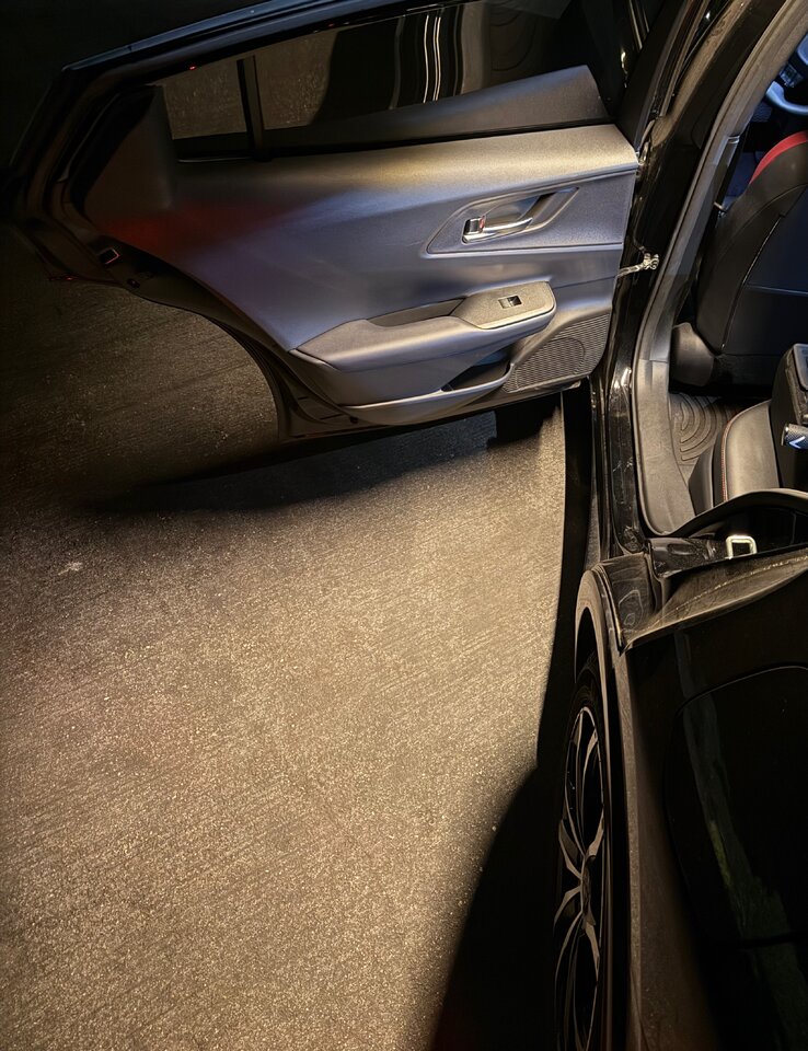

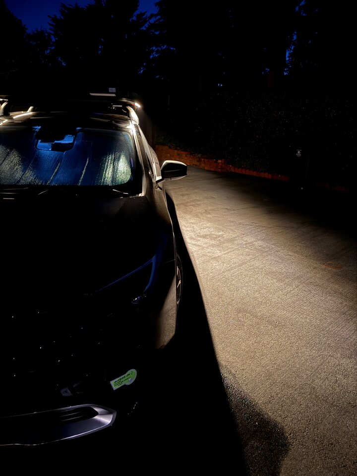

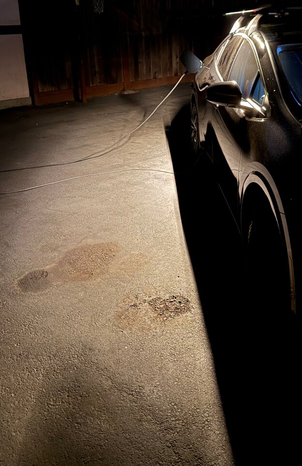

    I added 2 COB White Light LED strips to the channels on the side of the rack. Generates some nice light on both sides of the car. Not sure if the adhesive on the LED strips is going to hold up. Here are some pics.

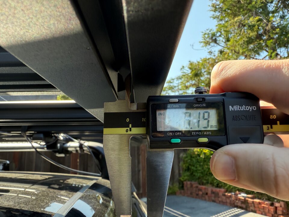

    Here is a close up of the side channels where I placed the LED strips.

    Love the lights @otatrant. How's the wind noise?

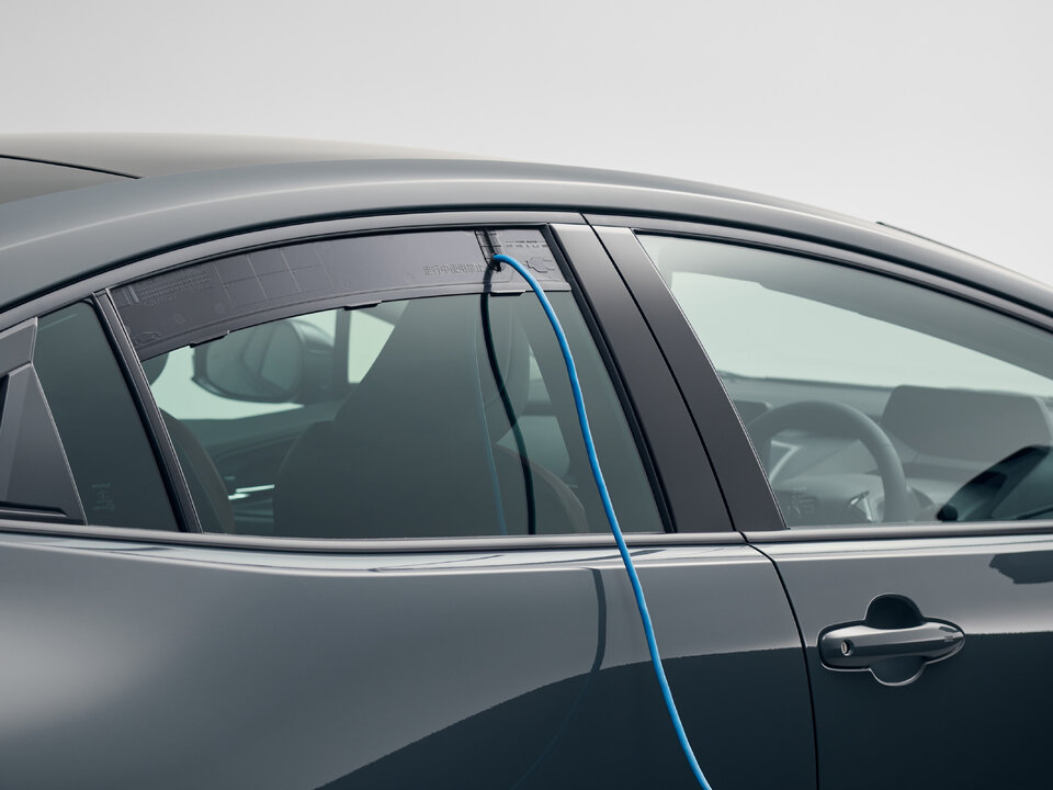

    Wind Noise: Prior to installing the Caprock Roof Rack I was driving around with the rear door glass stopper which allowed me to pass the power cord for starlink through the window. currently I have run the cable through one of the rear cargo panels. I find the noise from the Caprock much less annoying than the noise of the rear door glass stopper. Lower pitch noise. Kind of sounds like an airplane taking off instead of a whistle.

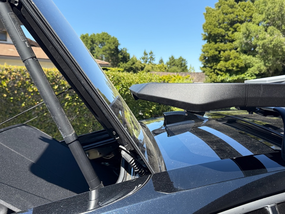

    I run power to Starlink by routing the cable through DECK TRIM SIDE PANEL then through a grommet that feeds wire to the break lights. The wire than comes out behind the brake light and runs up the gutters along the hatch and exits the gutter around where the strut attaches to the hatch. Works pretty well. Cables do not have to cross any of the weather stripping on the hatch and I didn't have to drill any holes.
