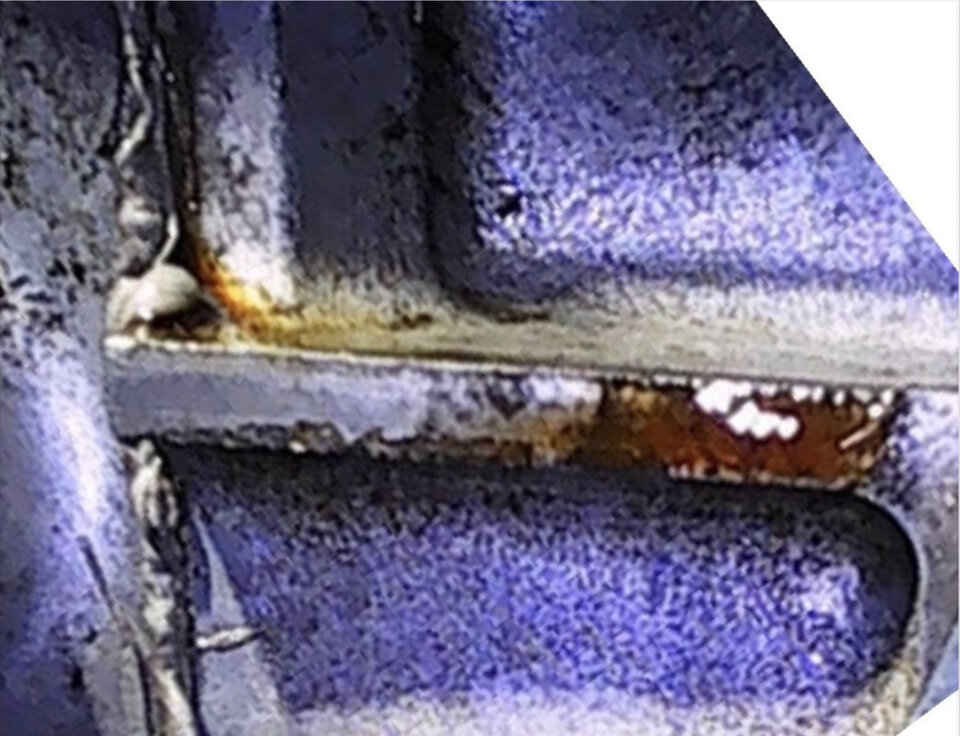

    I had my 2012 Prius C (166,000 miles) at the Toyota dealership for an oil change yesterday. They noticed a small puddle of oil under the rear end and showed me the photo of it. But I haven't seen oil on under my since I brought it home from the dealership.
    The total cost of the repair is $3660, including $2710 for the labor. It's a 15-hour repair so the labor is $180.67 per hour. The parts are about $300. Is the cost of this repair reasonable? Should I delay the repair until I see oil under the car?

    It's a reasonable price for a dealer to fix that. An independent garage can usually do it for about 2/3rds or less.
    Thing is, you probably don't need to fix it at all. It is a fairly common leak point on this model, but nobody ever lost much oil through it. It's just not a big deal for most.
    The oil loss rate is not likely to increase over the remaining useful lifespan of the car. Wait until yours proves itself different with a puddle.

    The fact that the dealer is trying to get you submit your car to nearly $4,000 worth of open heart surgery to fix a minor oil weep is telling.

    Sounds like the dealer is pulling the engine to change the timing cover gasket.
    I would get a second and third opinion until you found a price less than $1200. If not live with it but check the oil every two fill ups like your wallet and engine depended on it.
