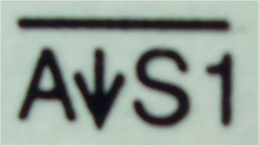

    Re: Tinting 101 - WINDSHIELDS - AS-1 LINE
    Here is my research and opinion on AS-1 Windshield Window Tint Laws
    I have been asked, "What does "AS-1" mean regarding the windshield tinting laws."
    Here's what I've learned regarding the windshield AS-1 line.
    This line is not relative to window tinting at all. It is related to the eyes visibility through the windshield.
    Some cars have an AS-1 windshield line depicted on them and there is a Standard required of Automobile manufactures to have this area depicted on the windshield if it exists.
    I do not find one on the 2005 Prius Windshield. However, my 1998 Mazda 626 windshield does have one. Here is a photo of the Mazda AS-1 line it's found on both sides of the windshield.
    If your vehicle does NOT have an AS-1 line denoted on the windshield, your vehicle's windshield is considered not to have one.
    If your vehicle doesn't have an AS-1 line and your state tinting law depicts tinting to the AS-1 line only, it is illegal to put tinting anywhere on the uppermost portion of your Windshield.
    If your state law does NOT state the AS-1 line and only inches from the top most portion of the glass you can tint below the AS-1 line to that limit.
    There are states that have laws that list both the AS-1 line and inches. If your AS-1 line is farther down than the let us say the 5 inches also stated, then you can have the tint lower than 5 inches from the top of the windshield to the AS-1 line. If your AS-1 line is shorter than the 5 inches stated you cannot tint below the AS-1 line.
    HOWEVER, I am not sure how tinting below the AS-1 line can be legal as an AS-1 line is mandated by the National Highway Traffic Safety Administration and with The Federal Motor Vehicle Safety Standards regarding window glazing and limits visible light transmission to 70% in the area below the AS-1 line. If the car doesn't have one then no windshield tinting is allowed by the manufacturer.
    Also, windshields are usually "Laminated Glass" which is a safety glass which breaks differently than the other windows in your vehicle when impacted. Adding tinting to laminated glass will also change the breaking characteristic required by regulations.
