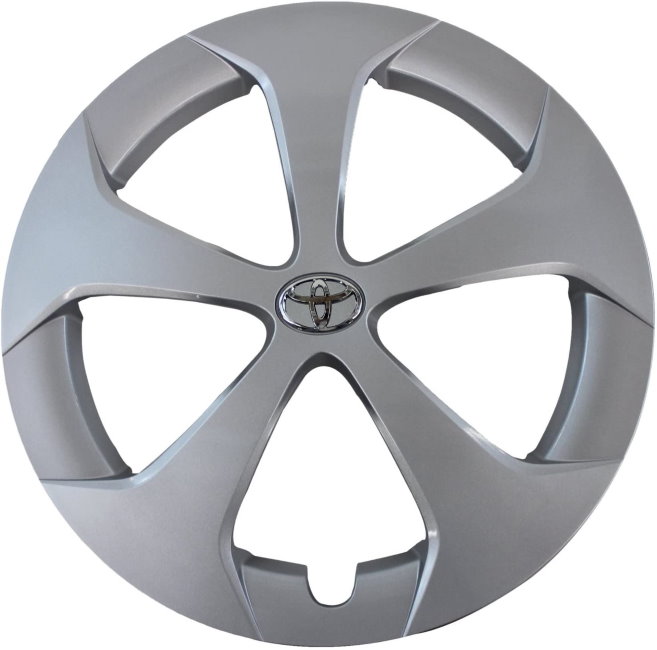

    Short form: what tire gauges and pumps (manual or electric) do you use to maintain the tires on this vehicle? Without having to remove the hub caps. Bonus points for tools that a reasonably spry elderly person could manage
    Long form:
    I'm currently visiting my elderly mother and even more elderly stepfather. The TPMS light is on in her 2012 Prius. My step father would normally have taken care of this, but he is even older and recent physical problems have put an end to his days of driving and working on tires. Their tire gauge accidentally went away with his car when they gave that to one of the grand kids. OK, thought I, tires are just tires, and pulled the tire pressure gauge and Serfas bike pump out of my 2007 to use them to check and/or fill any tires which are low. (Assuming it wasn't a failed TPMS unit in a tire.) Nope, the hub caps foiled me at every step. First the tire gauge, the kind that presses on perpendicular to the stem, wouldn't seal because there was no angle where it wasn't obstructed by the hub cap. Tried to hook the bike pump fast release on and it wouldn't clear the hub cap, which once again blocked access. The hub cap on the 2nd generation isn't very different from that on the 3rd generation, but the tire stem sticks up far enough out of the notch that these two devices attach without problem, whereas on her car it is down in the notch too far for them to fit. Later stopped at an O'Reilly's and bought their house brand dual headed pencil gauge
    https://www.oreillyauto.com/detail/c/xtra-seal/xtra-seal-10-to-120-psi-tire-gauge/xts0/151031
    which did seat nicely, and showed that at least that one tire was low - 28 PSI on the front. Yikes. (This model gauge is hard to read though, because it has such a large range the values for this car are just a fraction of a mm apart.) I could get a valve extender (should have done that while at O'Reilly's) to use with my pump for now, but that won't be a solution for her going forward. I need to find an electric tire pump that she can hook up, set the pressure, and let it run until it stops - without removing the hub caps. My mother is pretty spry for her age, but there is no way she will be pulling off the hub caps to maintain her tires. Picture a 90 year old doing this:
    Hers has different hub caps than in the video, these:

    I was trying to air up Tesla 3 tires. The car's had 2 sets of wheel covers, ostensibly identical but the tire valve opening on the most recent set was just slightly smaller, to were I couldn't get my pump's air chuck in. Resorted to extenders:

    They have valve stem extenders. Different sizes. You could look on ebay, or a tire store
    might have them.
    A wide flat blade screwdriver will get the WHEEL covers off. Depending on how your
    fingers are, you can grab the edge and give it a yank...

    I grab mine at the inner 'spokes' and yank, plenty of room for my fingers, unlike at the edge.
    But I don't have to do that for routine checks and airings, because on my 2010 the covers don't interfere with my air chuck.

    Found an old bike pump in the corner of their garage with a smaller chuck. That one fit on if the hose was aimed at the hub, but the lever was so stiff I was afraid of breaking the stem from the force. Now I just need to find an electric pump with a chuck that size or smaller, with a lever that an old lady can move, and she should be good to go.

    Is the tire end of that tube a quick release of some kind? I can never tell in the pictures if it is a screw on hose or not. The ones with a lever it is obvious that they are a quick release.
    Another thought, I believe the TPMS units are not OEM. Perhaps the OEM TPMS units have longer stems, so that the tip is not so deep into the hub cap, and they are easier to get to? My 2007 is right next to my mother's 2012 and the thickness of the hub caps does not seem very different, which would put the variation at the TPMS units.
