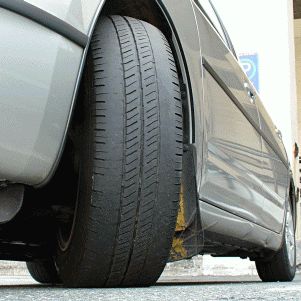

    Toyota's "recommended" pressure causes this:
    along with low MPG...

    So Hobbit you must explain to the uniniated what that means? I get it, but I would guess that not everone sees a thousand words.

    It means that under-inflated tires wear on the outer edges.
    Over-inflated tires wear on the Center.
    At Toyota's door-panel Tire Pressures (35 Front, 33 Rear), the OEM tires are decidedly under-inflated by this measure. I can see it every day in parking lots.
    I've run mine between 40 and 44 in the front depending on mood (and of course 2lb less in the rear), and I got remarkably even wear. I just replaced the OEMs at 40K miles with 2-3mm left before the wear bars, so I could have technically gotten the expected 50K out of them, but I know that tire performance drops off siginificantly before they reach the 'absolutely must replace' point which is what the wear bars really are.
